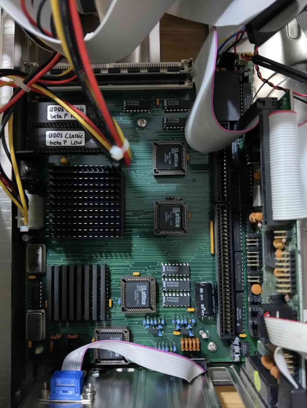

It started life as a Q40 and I don't remember an upgrade, but It's entirely possible that I may have forgotten.
The processor is obscured by a heatsink. I'll check 161(a6) and BogoMIPS after work.

Thanks for providing the Q60 privileged treatment.Mark Swift wrote: Wed Dec 18, 2024 8:12 am It has survived by being stored at the back of my wardrobe. The computers stored in my loft have not faired so well.
Thanks for the nice internal view on your Q60. Can't see the upper quartz oscillator exactly, but by now I bet it is 60.0 MHz. A frequency never used on Q40, and a clear idicator it must be a Q60/60.Mark Swift wrote: Thanks, I got the Q60 yesterday. Plugged it all in last night... works great.
Just not sure why the factor between our machines in Q-Top is 1.39 and not exactly 1.33. I did not optimize the Q60 DRAM controller especially for 60 MHz. It is probably the 66 MHz controller running 10% slower. Since SMSQ/E does regular cache flushing to DRAM (even when not required) this might be an explanation.
By the way, I noticed something a little weird. Under QDOS Classic with copyback cache, I get exactly 160.0 BogoMIPS as I should. Under SMSQ/E 3.3 it is only 157.9 BogoMIPS. I have no idea for what they consume 1.3% of CPU time with no extension loaded and no other job running.

Re: Qzero with SRAM extension reaching 40 MHz 68040
Hi Peter,
Yes, its an 060.
The quartz oscillator is 60.0 MHz and PEEK(164001) returns 96,
Under QDOS Classic with copyback cache I get 119.97 BogoMIPS. Under SMSQ/E 3.41 I get 116.33 BogoMIPS.
I must have been as happy then to have an 060 as I am now to find out I still have one.
Sorry I can't help with the Q40 timings though.
Mark

...I can't believe I didn't remember thatPeter wrote: Wed Dec 18, 2024 9:20 amMark Swift wrote: Thanks, I got the Q60 yesterday. Plugged it all in last night... works great.

Hehe, very good as it still seems to work fine!Mark Swift wrote: Wed Dec 18, 2024 9:04 pm I must have been as happy then to have an 060 as I am now to find out I still have one.
How did you manage to get a full size picture? Still a CRT monitor?
