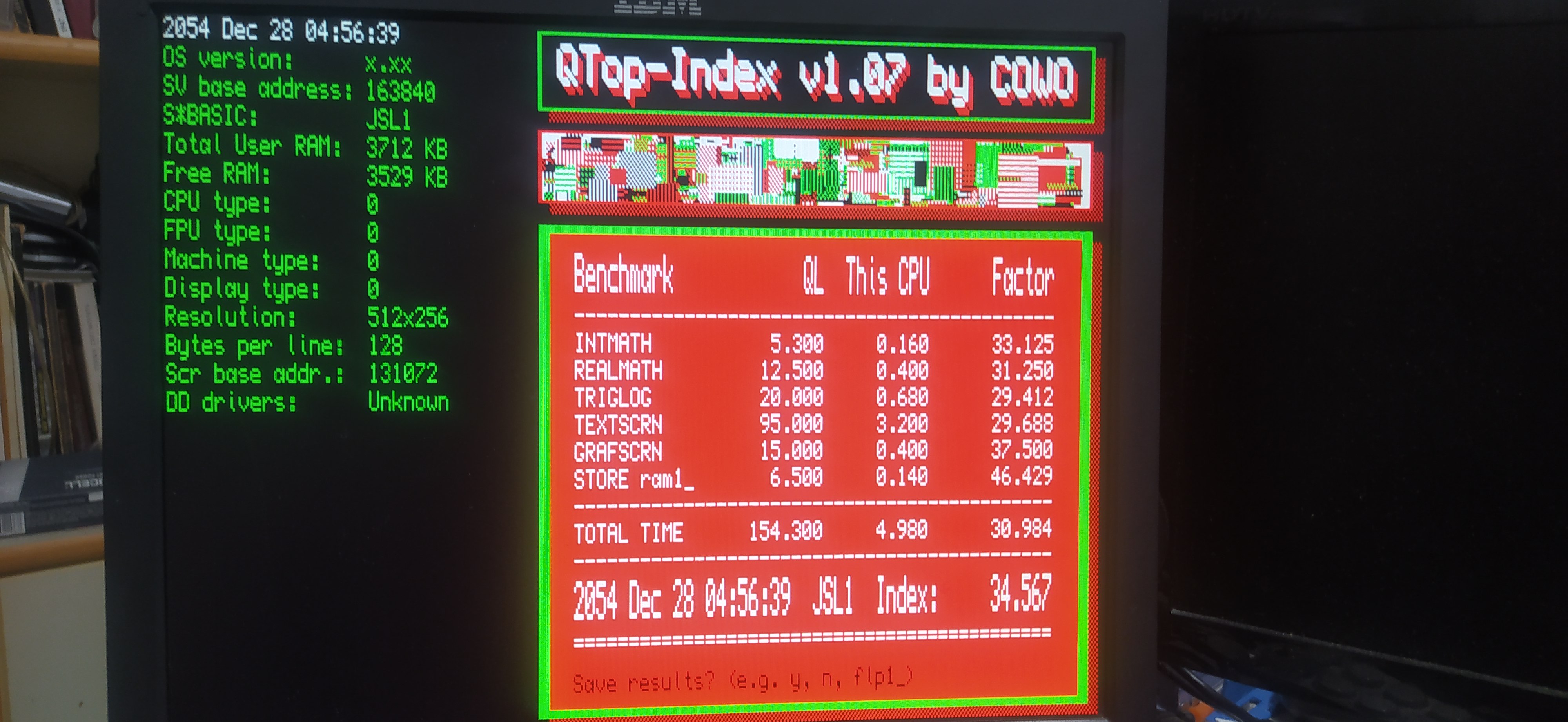

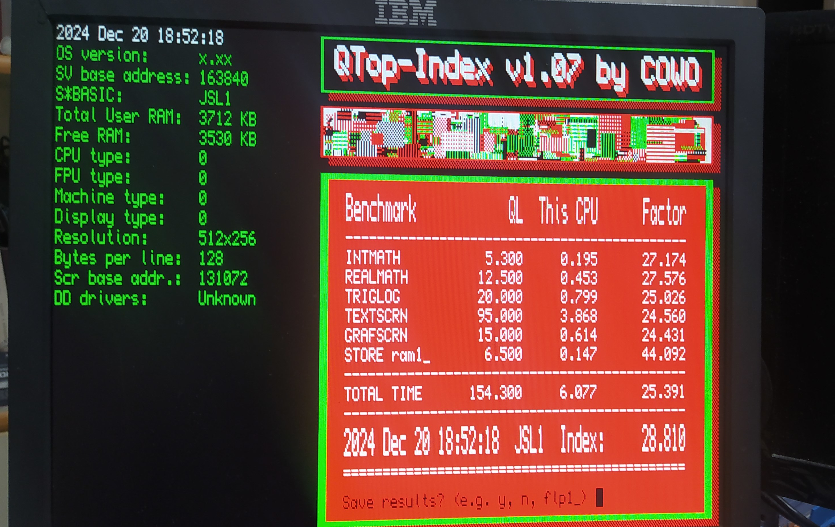

I did a little increase in speed.
lliont
Posts: 342
Location: Athens, Greece
Re: QLion Gold Card
Post by lliont »
and a bit more

Good grief, my friend!
You are determined - you are a true credit to the community!
