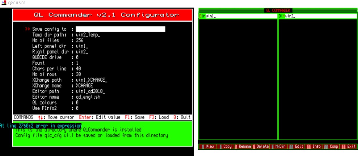

Your code implies thet it uses QLiberator and TURBO Directives which I assume require their runtime modules. UNZIPing your Folder there is a file qlc21rtm_obj and a file unsizp which I assume contains the code for QL Commander to operate.
I attempted to use the QL Commander Configurator with my QPC2 setup but as soon as I hit Enter it comes up with Line 2760:2 error in expression:- EDIT$(x$,text$(crtline,2)) comes up with invalid syntax.
Forgive my ignorance in QL O/S and Compiler skills but can you give a more explicit explanation to the necessary Commander load requirements? Or upload Quill View as a Plain Text Doc assuming it has info pertaining to the load and running of Commander.
Que? Does Commander LRUN a Basic Prog when Compiled ie as qlc21_obj

The manual for version 2.0 says
Extensions used
QLC uses the following extensions :
• qlc_code (contains More_code, Header_code and Function_code, all from DIY Toolkit)
• QPTR toolkit
• Turbo Toolkit
• Toolkit 2 (On Qemulator use v2.32 – on QL at least v2.88, but v2.32 is recommended)
• PE environment (hot_rext, ptr_gen, wman – only on QDOS, not needed on SMSQ/E)
Your selected editor may use other extensions, so make sure all are loaded
Yes, QL Commander can LOAD and LRUN a program, LRESPR an extension etc.

Extensions used
• QPTR toolkit
• Turbo Toolkit
I have created a new version of the manual.

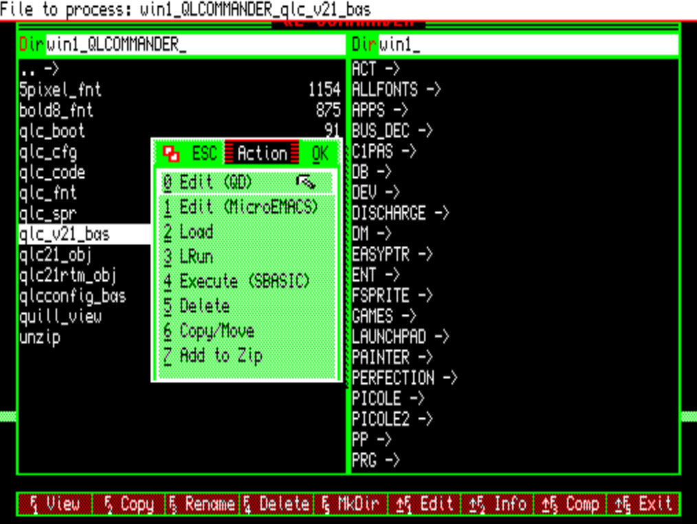

But keep in mind that QLCommander needs an expanded QL and works best with some kind of mass storage (QL-SD, QUBIDE or at least a double FDD)
What kind of expansions it requires to work fine?

If you read the User Manual, is stated the extensions used:
This implies at least a QL with 256K ram expansion, or full 640K.
