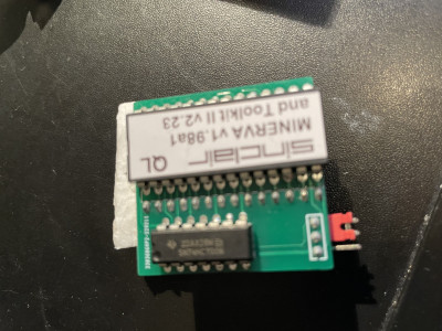

Out of interest, when you bought the Minerva EPROM, was it mounted on its small PCB/daughter board, or just a lone EEPROM IC?
Also, what version QL motherboard (Iss 5, or Iss 6/7) do you have?
It's all fixable, but we'd need to dig a little deeper to know how best to do so...
You might start by posting a photo of the original ROMs and then with the Minerva daughter board fitted.

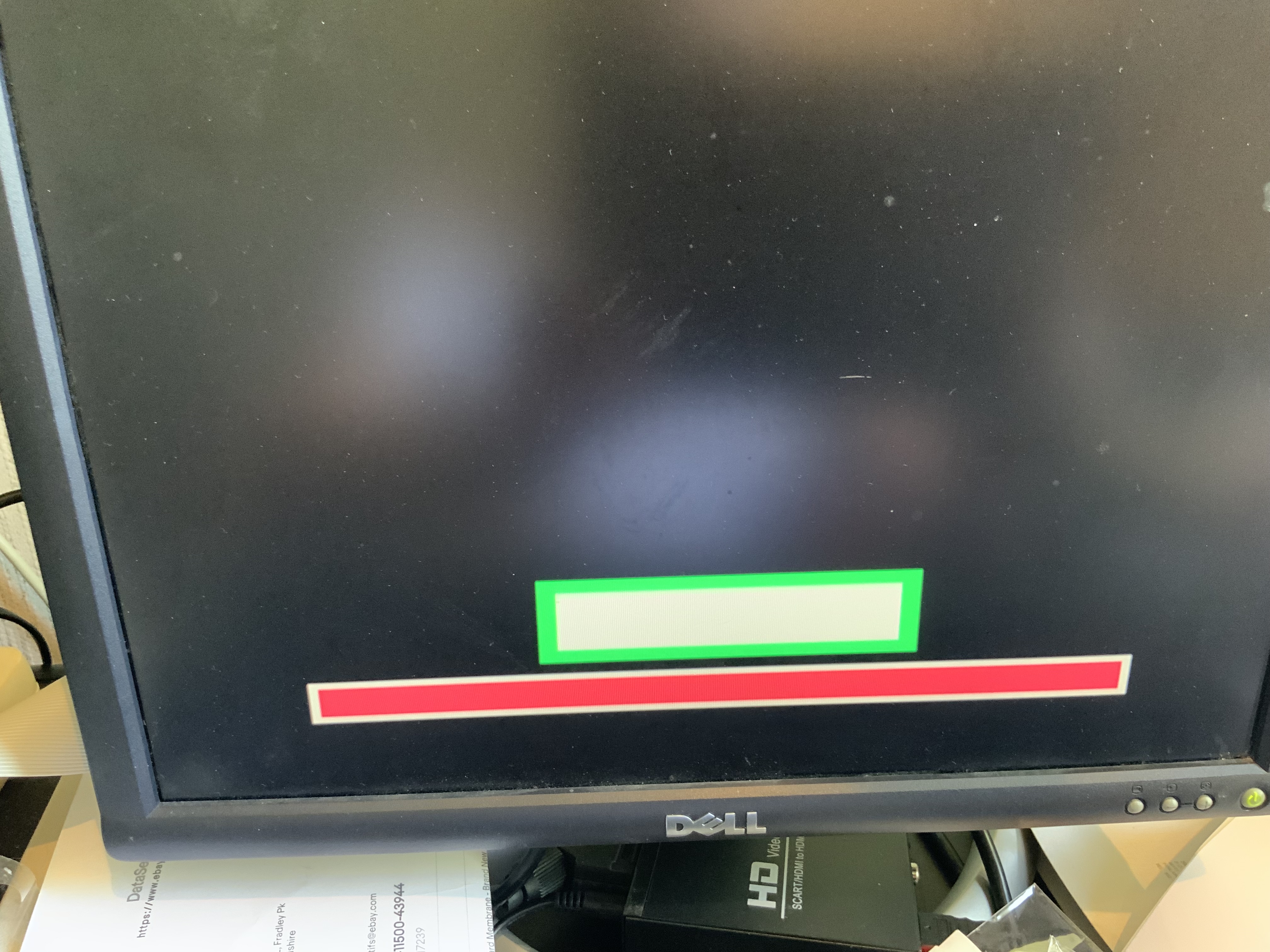

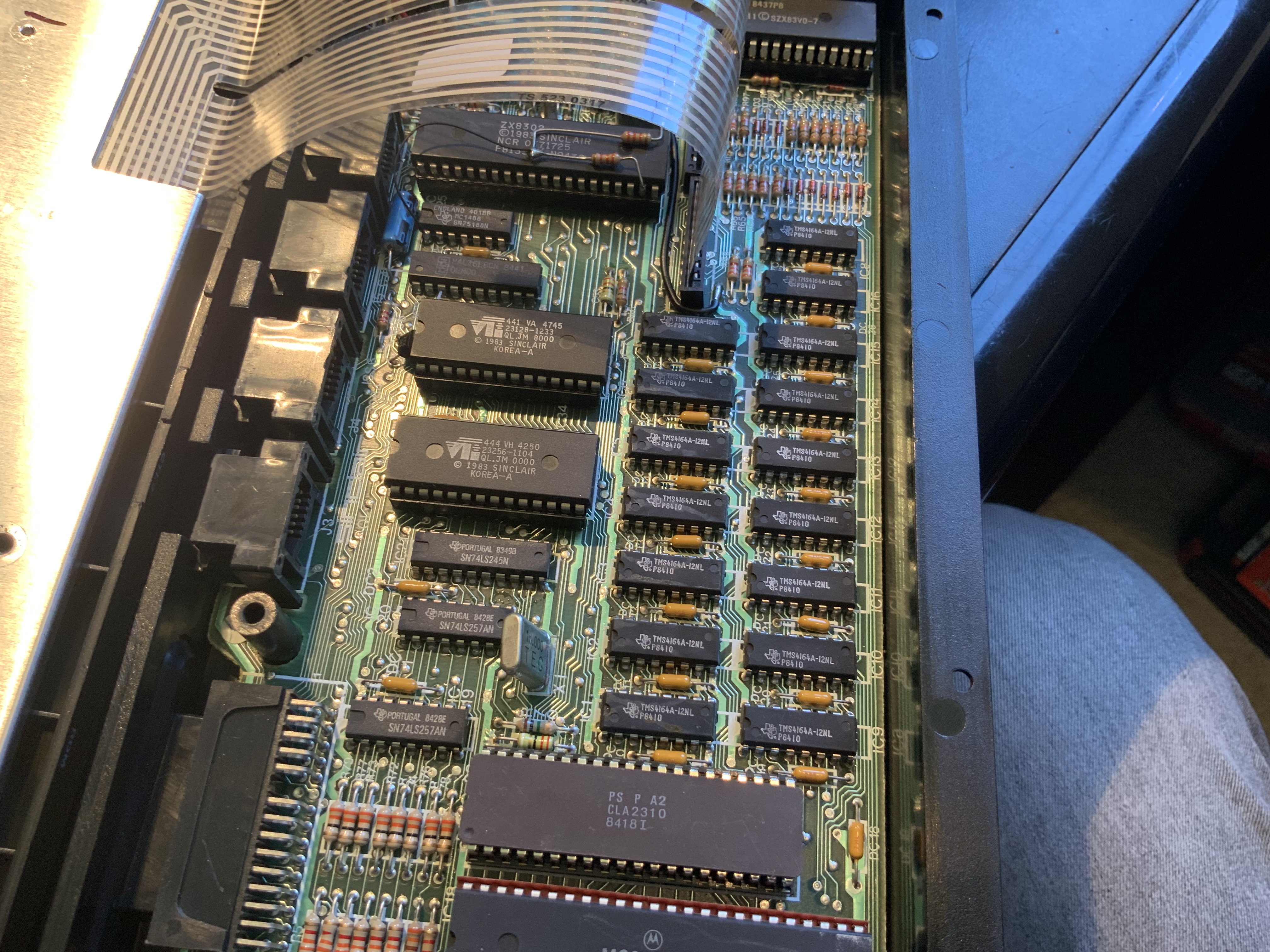

I toke out the roms again and cleaned the connectors and we are one step further, we now get the start-up screen but without the text in it and no reactions on the keyboard
The board is an issue 6 and the pics are attached
Fred
Fred

Shouldn't the Rom ICs be the other way around?
Edit, they are pointing in the right direction but the one marked 23356 should be in top position and vice versa, or?
