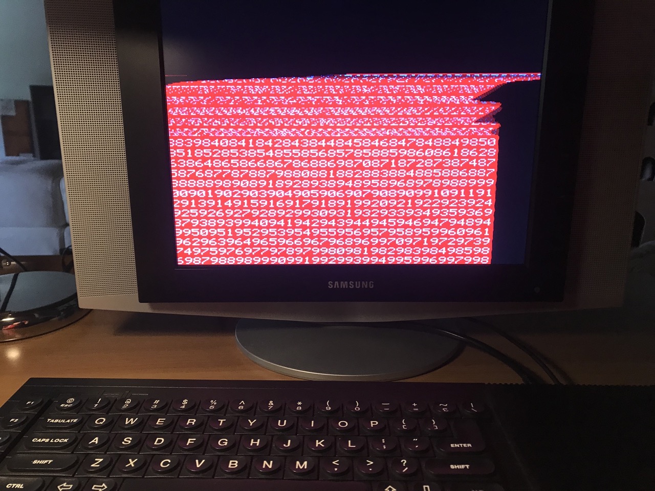

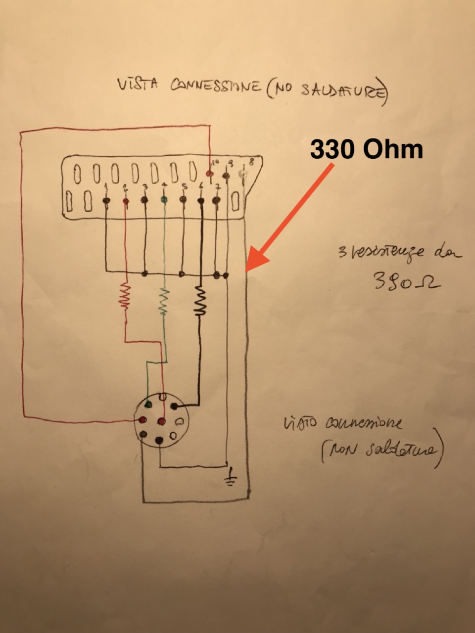

Hi guys, I found some time to spend with my QL and I built a Video Scart cable myself. I followed the diagram below (the sockets are seen from the front, NOT the solder side). It works very well with a couple of TVs at home but on a small TV/Monitor (where among other things I would like to always keep it connected to my QL), it doesn't work: on the latter TV there is a message "no signal" when I turn it on and then - when I press F2 - I see a red image out of sync. The resistors are 390 Ohm. What do you think it could be?

Hi Robbizz!
[Edited to correct SCART pin numbering in original post]
I've had success creating a number of QL -> SCART cables over time, based more or less on the really useful site:
http://www.fruitcake.plus.com/Sinclair/ ... ableQL.htm
I guess you might have used the same site and, like me, you've used that 'trick' to use the Comp. PAL Video (QL pin-1) output to drive BLANKING (SCART pin-16) as a convenience to present c. 1V+ and thus trigger the TV/Monitor in to RGB mode (vs Comp. Video.)
However, as per that site, I also add the 330ohm resistor in series with the TTL CSYNC signal in to SCART pin-20 (Video-in), effectively lowering the CSYNC signal presented at Video-in to around [75 / (330 + 75) x 5V =] 0.93V pk.
Some TV/monitors might be sensitive to the TTL level appearing on pin-20, so I recommend adding that series resistor to effectively lower the pk voltage present at Video-in.
Again, referring to the above site, I've never needed to drive the FUNCTION pin (SCART pin-8), but again, some TVs might be fussy, though the effect you describe doesn't sound relevant to driving this pin.
Let us know how you get on!

Thanks for the suggestion. I tried to put a 330 Ohm resistor in the point indicated by the arrow, but unfortunately I still receive no signal (when there is the initial F1-F2 screen) and then I see the screen as per the disturbed photo (exactly like before).
Note that with the same cable, on my TV at home, it works perfectly (see last photo).
I don't think that the Samsung TV has problems managing RGB signals, because I tested it using an Atari ST with Scart cable and it looks good.

OK, so all I personally can think-of is that this monitor doesn't like the QL's 'over-scan' timing and is struggling to sync properly.
