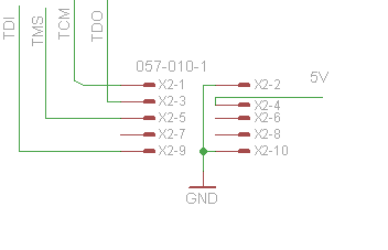

Okay let's try that. Do you have schematics and placeplan for me, so I can see where the JTAG lines are?lliont wrote: Wed Jan 24, 2024 12:21 am We can try slower access times even I don't like to make it slower![]()

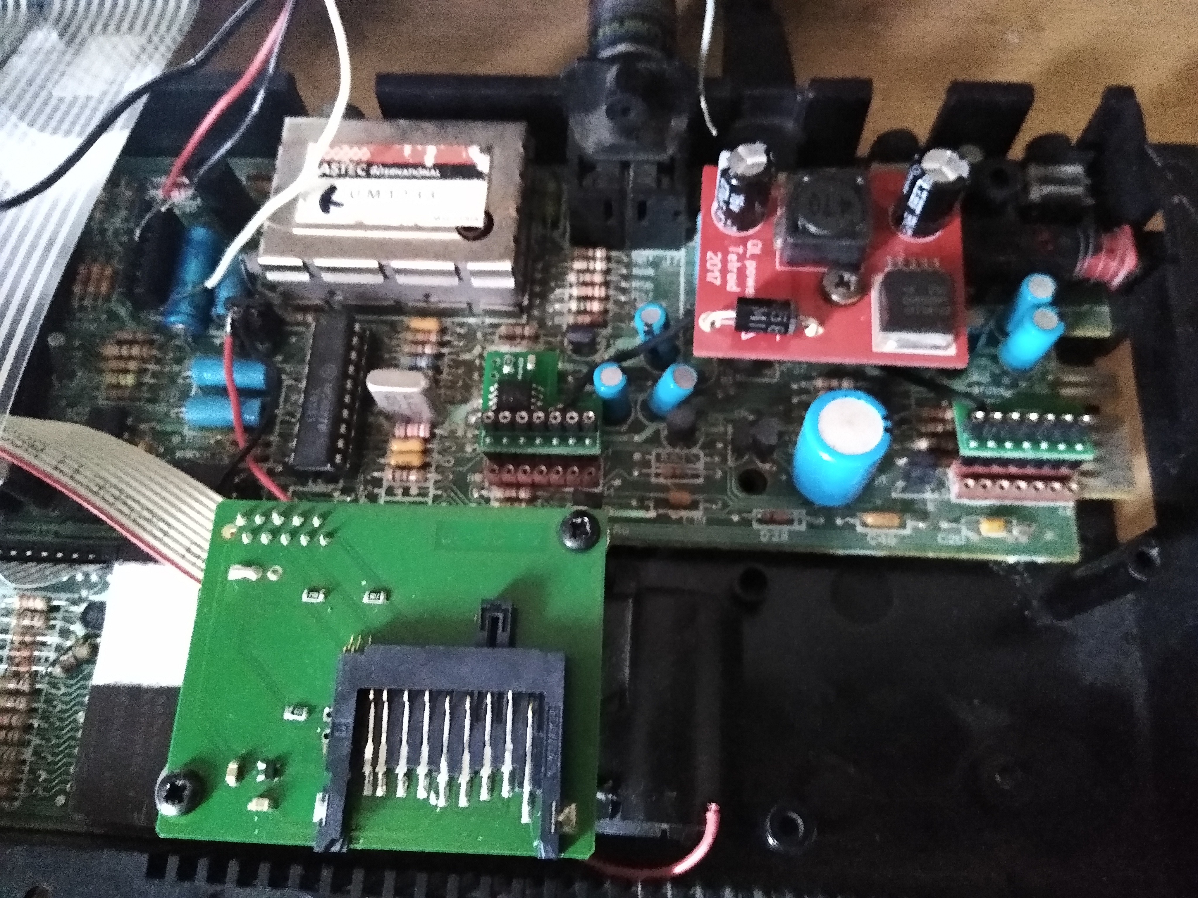

I have a Tetroid Power Regulator in place of the standard QL power Regulator and heat sink: That is the only difference I can see, I can not see any problems with the ULA board send to me.
Is there any commands I can try to test the operation of the ULA?

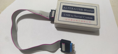

Do I need the bloated Quartus II installation, or is there a leaner programming tool?
I use Quartus 13.0.1 for the older cpld programming, newer quartus versions may not support MAX7000S family.
Some usb blaster clone's driver crashes windows 10, work well with earlier versions of windows.

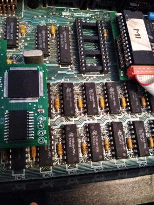

I have TMS4164-15NL DRAMs soldered to the QL board:

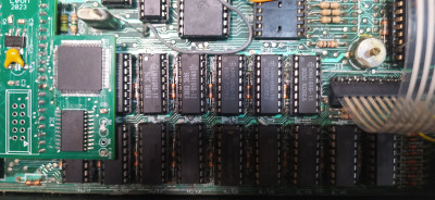

Well there is no doubt it has to do with dram but is it that all QLs with KM4646A-15 DRAMs have the incompatibility problem?
I had an idea, in my QL I installed sockets for the drams so if I find KM4646A-15 DRAMs I can directly test them.
Are you sure the dram type is spelled correctly Peter? I think you mean KM4164A
The KM4164B-12 work without a problem you can see in older pictures that half of the drams in my issue 5 QL are this kind.
I found also 3 ics KM4164B-15 to test

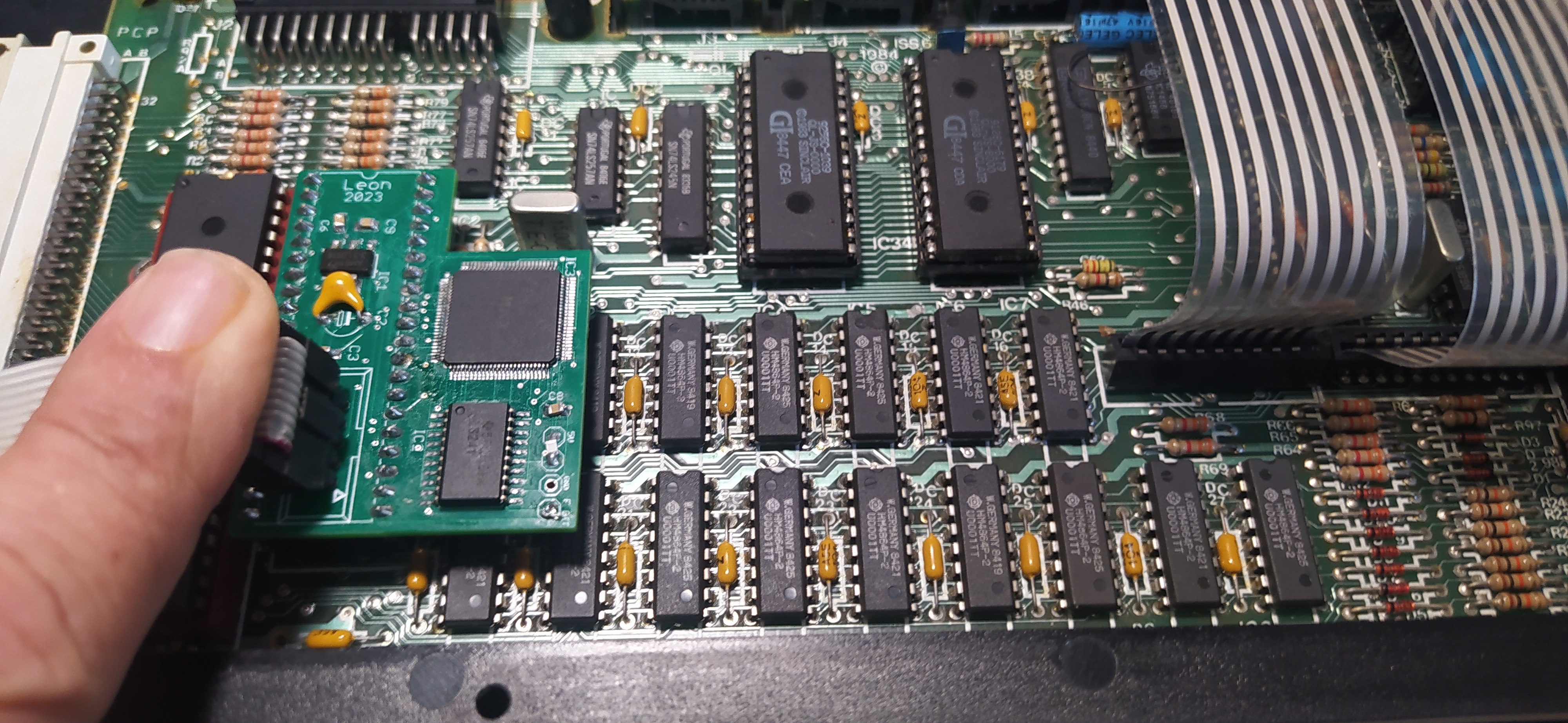

Well I reproduced the problem.
Initially QL booted but after a while problems appeared i.e. random pixels on the screen, then I made some changes and now it works.
I think I solved it but I'll give it some more time.
Tested with only 3 of these @##$% dram ics.
