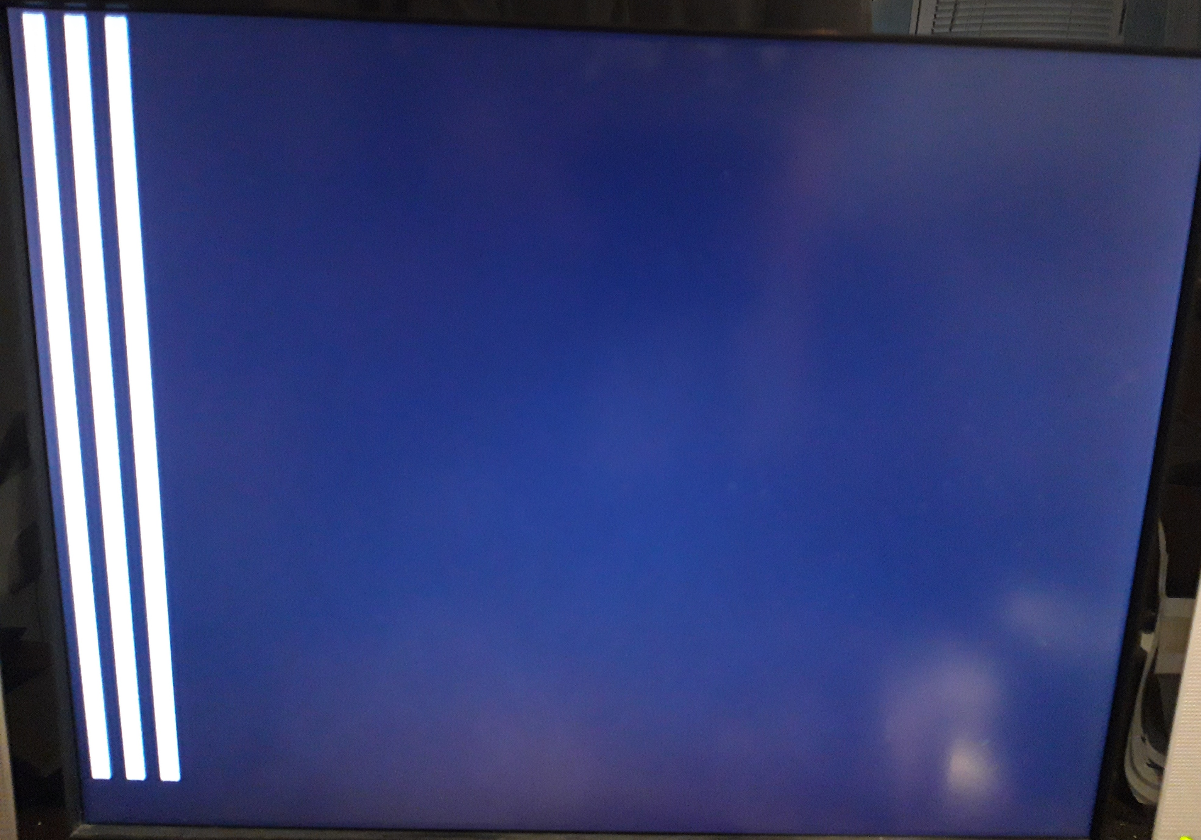

Just got my Merlin Tonto out to try out Stephens' C1 disk interface clone. I didn't get as far as plugging that in though, as I get a chequered pattern and then this screen with 3 vertical lines on boot:
It was working a few months ago when I packed it away.
Likely RAM issue? I can't find any info that mentions 3 white lines as a diagnostic aid. I had a spare CPU so swapped that, no difference. I pushed down on the socketed chips and also removed and re-plugged the daughter board, no difference. I felt the chips to see if anything was unusually hot - it wasn't. I piggybacked a 4164 RAM chip on each of the soldered RAM chips, minor pattern changes occasionally, but no real difference, still 3 vertical bars.

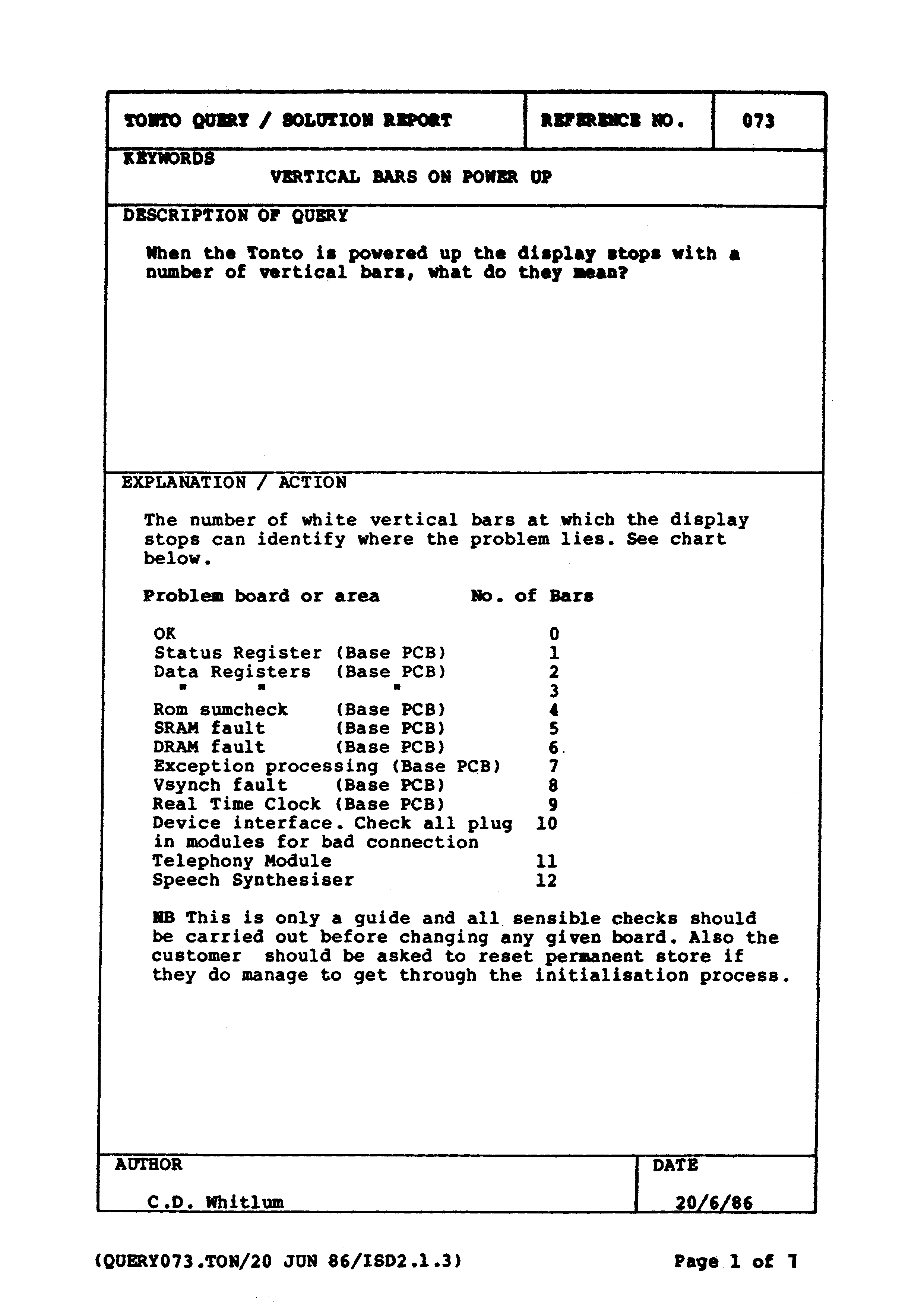

Here are the diagnostic stripe meanings. I'm pretty sure I posted them elsewhere.
Three stripes = "Data Registers" whatever that means. Maybe some flop-flops somewhere?

Thanks. I did try unsuccessfully to find that info...
Hmmm, data registers.

You need the ROM pack and the telephony module to fully boot, it will hang at a blank screen otherwise. It doesn't matter about the 9V battery, that merely keeps the real-time clock going.
The 3V battery keeps the "Permanent Store" SRAM energised. It isn't required to be OK. If the contents are corrupt the OS will give an error message and clear it, but that happens well after three bars.
The screen stripes are set a very early part of the boot sequence from what I've seen. Three stripes happen even before the memory test, as do the ROM CRC checks. I hope it's not the ULA on your CPU board that's gone bad.
