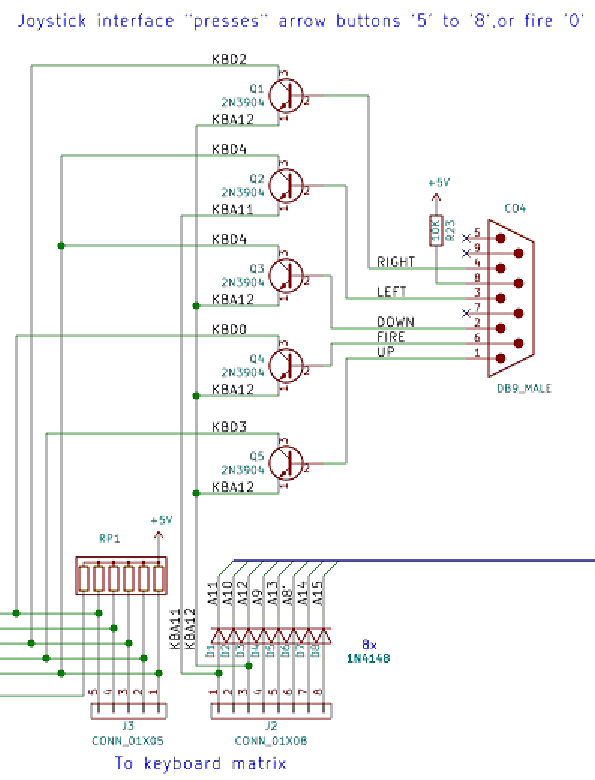

I did try a ferrite toroid (ended up trying multiples) and it had no impact. Asked Charlie Ingley, since he developed a ZX81 ULA substitute and he pointed me in the right direction. The extra gamepad cable is adding too much additional capacitance for the ULA to properly identify the key presses. So a passive approach isn't going to work. However, add a few transistors and 5 volts and should easily add an active circuit to do the same thing.
Here is a diagram of one that Charlie found for me, though mine will have 8 transistors and be wired directly to the 8-button gamepad:

You could modify the ZX81 to use a bank of transistors to boost the signal available on the address lines that scan the keyboard, or use a TTL buffer chip - this also helps protect the CPU too.
You could also use protection resistors and diodes on the input side going into the ULA, - this should also help.
