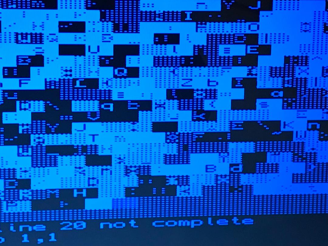

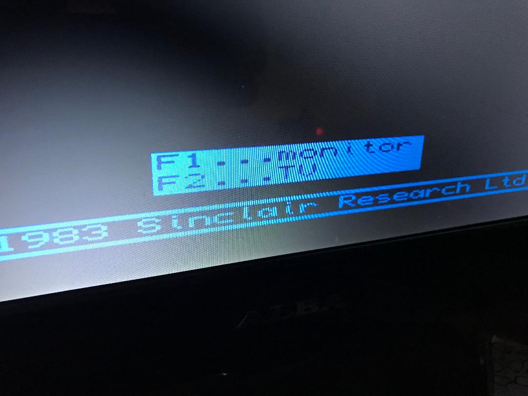

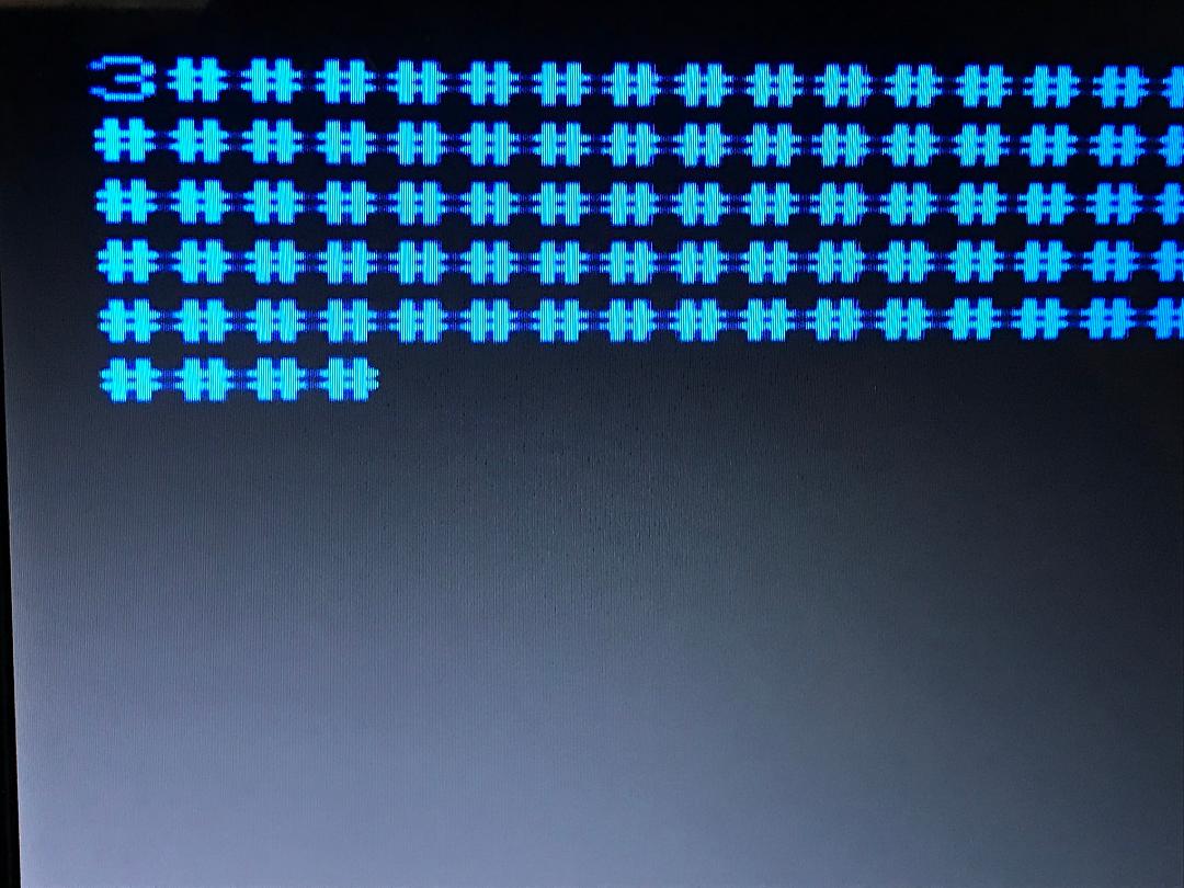

Hi there, I've just got another QL and all works well apart from when I connect it to my TV via RGB to SCART lead the only colur I can get on screen is blue ie. text is all blue and background is black - my other QL works fine with this lead, so I assume it's a problem with this QL - could anyone point me in the right direction pls :-). I've added a couple of screenshots.

That's actually a bit of bad news: The individual colour signals are directly produced by the ZX8301. If one or some (as in your case) of them are missing, it's somewhat likely that thing is toast.
Do you have a chance to check the RF output for colours?
Another possibility: very often, the expansion connector (left hand end) of the QL has bent pins. R, G, and B are exposed there, with the "proper" way of bent, I could imagine it affects the colour signals.

Thanks for that, I've got a ZX8301 I could swap and try, and I'll have a look at the oins too. I'll also try the RF signal and see if that's any good.

Yep, as you rightly diagnosed it was a faulty ZX8301, swapped it for a good one and it worked perfectly - thanks for your expert advice :-)
