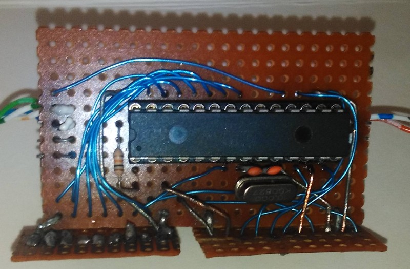

Ruptor
Posts: 420
Location: London
Re: Keyboard from where
Post by Ruptor »
I finally wired up the PIC interface board that will convert the QL membrane input pins to give me a serial input that I can connect to a computer. After belling out all the wires I flashed a chip with my first version of software stuck the 5V from the QL on it and the 10 MHz oscillator is running so some of the code is correct for the clock set up. :) I have done the code for reading the Hall effect keyboard to give it serial output to match the QL PIC receiver but I have to rewire the keyboard and make a second PIC interface board to read it. Not sure how long it will be to my next post that will be when a computer serial port can talk to the QL. :?
