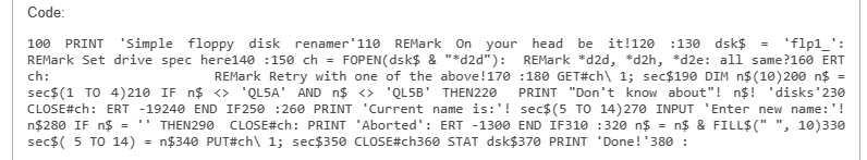

This is how that chunk of code came out for me - I use Blogtrottr https://blogtrottr.com/ to deliver Forum posts to my email. I think it expects CR+LF at end of lines of CODE whereas the Forum only supplied one to the feeds. Not moaning, just had to scratch my head for a bit before I realised what was going on!
Blogtrootr CODE feed
