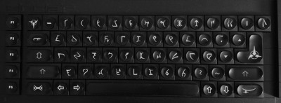

Here's the Finnish keyboard: EDIT: replace image with a usable one, thank you Peter

I am collaborating with Stephan and Peter in the development of the QLbase, focusing on the internationalisation (i18n) of Stephan's marvelous QL matrix to PS/2 converter that is built-in to the board.
Thank you for the photos of the various country keyboard layouts that have been provided thus far. I'm focusing on adding French and Italian support in the first instance as we already have the respective IBM drivers for these languages built-in to SMSQe. The UK and German layouts are already mostly complete.
In addition to the visible key caps, some country KB layouts also make significant use of the CTRL+Key combination for common characters, which of course are not displayed on the QL keycaps and therefore not in the photos.
For this, I would need visibility of the country-specific copy of the QL User Guide, Concepts section that lists all the key-strokes, including CTRL, ALT etc.
So, if anyone here has a country-localised copy of the Concepts section of the QL User Guide they could attach here, I'd be very grateful. I'm not even sure whether Sinclair released language specific guides, but if you can dig yours out and provide the relevant section, I can proceed with the localisation of the KB driver.
Once French and Italian are complete, I'd then look to adding other country IBM KB support to SMSQe itself - and then to the QLbase - and will update this thread then to ask which countries I should focus on.
As a final note, I can report that I have been using a couple of the QLbase boards with both my Q68 and a Qzero for a couple of months now - both with great success. I'll share the results of my tinkering in due course, but actively encourage any existing or forthcoming Q68/Qzero users to look in to the QLbase - especially if you have a spare empty QL KB/case waiting to be put to good use!
