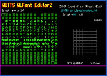

I’ve been tinkering away and come up with a full 256 Character Font Editor. The QL uses two Fonts sets Zero to 127 and 128 to 255. The printable characters being 32 to 127 and 128 to 191, these have a key or key combinations. The others as with all codes can be printed using CHR$(n), n being 0 to 255.
(D)DIR allows changes to the 16 drive names and a drive +SubDIR if applicable. (L)oad operates by selecting a drive/SubDIR and will then check for ‘_fnt’ Files if none are present or medium not available a ’No File Found’ will be returned. If _fnt files are present select one to Load. The two bytes at the beginning of the file is checked and the font file loaded into one of four setups. Characters 0 to 127 is position one, 32 to 127 is position two, 128 to 191 is position 3 and 128 to 255 is position 4.
When Saving a Font group select one of the four positions. The Font file name and drive can be Edited, this may return a DEVICE ERROR if medium not found or the option to Overwritten Y/N.
See pervious posting for additional help

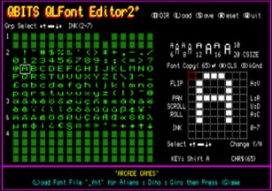

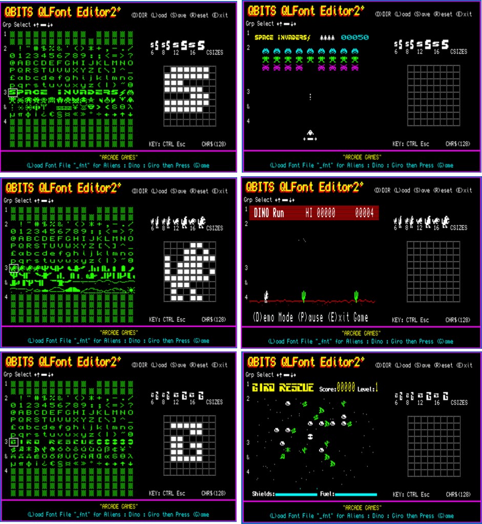

QBITS_FontEdit2_SE allows 0 to 255 Font Codes to be Edited.
Font Copy < n > to load and modify an existing Font Character, (#) CLS for NEW pattern, (B)kGnd to toggle Black -White STRIP & INK, then FLIP, PAN, SCROLL, ROTATE or (0-7) to change INK colour of Bitmap.
(D)DIR to access Subdirectories, (L)oad & (S)ave _fnt file. (R)eset and (E)xit with Y/N prompts.
By loading Aliens_fnt, Dino_fnt, or Giro_fnt from supplied and Pressing (G)ame, the selected ARCADe Game is displayed for playing.
Exit will return to the Font editor.

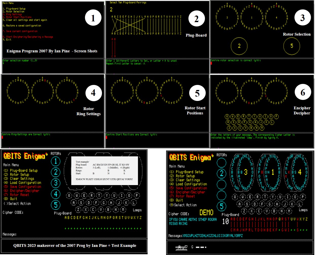

QBITS_FontEdit2SE
As the Font Editor is the most recently worked on Prog this has been given the upgrade, Plus the Font Chart’s INK colour can now be changed from Red (2) through to White (7). Colours Black and Blue I excluded as the background is black and also to avoid a blackout with QL platforms that only work with four colours in Mode 4. ARCADE Games - Dilwyn included a time loop variant that could be manually changed as DINO has CPU timing issues across the various QL platforms. In light of this I added a Speed Adjuster.
Here I have an Updated Prog for review. While looking for articles on Compiling I came across a QL Enigma Program by Ian Pine. I downloaded and scanned the Prog pages to convert into a text file, and without much success at first. Eventually one format was accepted by the QL Interpreter, but with ’MISTAKE’ against a number of line entries. I did eventually get the Program working. Functionally it did the job intended but I felt was unfinished and a little underwhelming graphically for something written in 2007. So, I decided on a QBITS makeover.
The Progs
