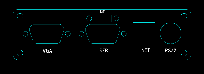

The Rear panel only has 8mm of space between the case top and the VGA & SER sockets.
I tried putting 2 x 3.5mm sockets with switch and terminating resistor over the VGA socket there was no room for the installation.
There is room for 1 socket between the VGA & SER Sockets, but this limits the QL NET functionality of the Q68.
So I think, the twin sockets should fitted to the right hand side, so I have drill 2 x 6mm dia. holes with a 8mm dia. x 1mm counterbore for the socket securing nut.
A little more work, should worth it.
Posts: 4756
Re: New Q68 Case
Here is drawings of the Rear Panel locating the I2C connector:
Q68 Rear Panel
Q68 Rear Panel

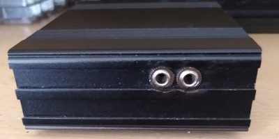

Here is the old Q68 Case from right hand side with QL NET connectors installed
Q68 Old Cade with QL Net Connectors installed

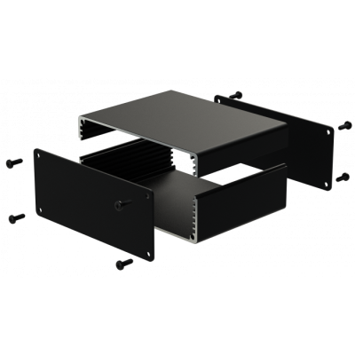

An alternative solution to keep the QL NET connections on the Back Plate would be to have a slight taller case:
Makes the Q68 have 14mm more head room, maybe for a possible expansion board...
