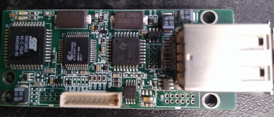

Here is a picture of the Black Box USB-PS2 adapter:
It looks to be a double sided PCB, with a few custom chips.Regards,
Re: Q68 support thread
That middle chip is in the Belkin KVM I have - it's from Cypress - "Embedded USB Host/Slave Controller" - can be configured as either the host or one of several peripheral types. Interfaces to a micro.
In the KVM it's a host controller for the keyboard and mouse if plugged into USB ports.
