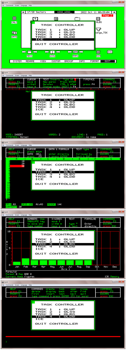

Re: Choice window manager for ICE
So I created a Psion task file (Exchange_TSK) using Choice with each of the 4 Psion programs as a task and each reserving 32K for screen on a RAM expanded QL. I guessed at the memory usage (gave each 20K which was enough for 640K RAM)
It works pretty well to switch quickly between each app. You can even get rid of Choice as all you need is the TSK file which itself is a 3K executable (I think it needs ICE to run). But a neat way to package the Psion suite and switch between them without corrupting the screen. Pretty cool...one can only imagine if the QL had persevered and ICE turned into PE, the TSK mechanism would have been a cool way to package software with multiple executable.
I got Choice configured to run Digital Precision's Conqueror....twice. I used my 512K Expanderam and Kempston Disk Interface card hooked to a single floppy. Configured both copies for 200K of RAM and no screen save. They both booted up, and using the "CTRL" key selection to pick a floppy (it releases the other), was able to boot one instance off of floppy 2 and the other instance is looking for floppy 1. Unfortunately I only have 1 floppy drive so I can't complete getting the other instance to boot, but I'm 99.9% sure it will since it's asking for the floppy, looking for the boot sector.
Pretty cool. This is JSU QDOS with ICE and Choice configured TSK file, which reserves RAM and zeros out job priority when tasked out (as far as I can tell). This kind of stuff is why I love the QL, just some cool tinkering you can do on the software side.
