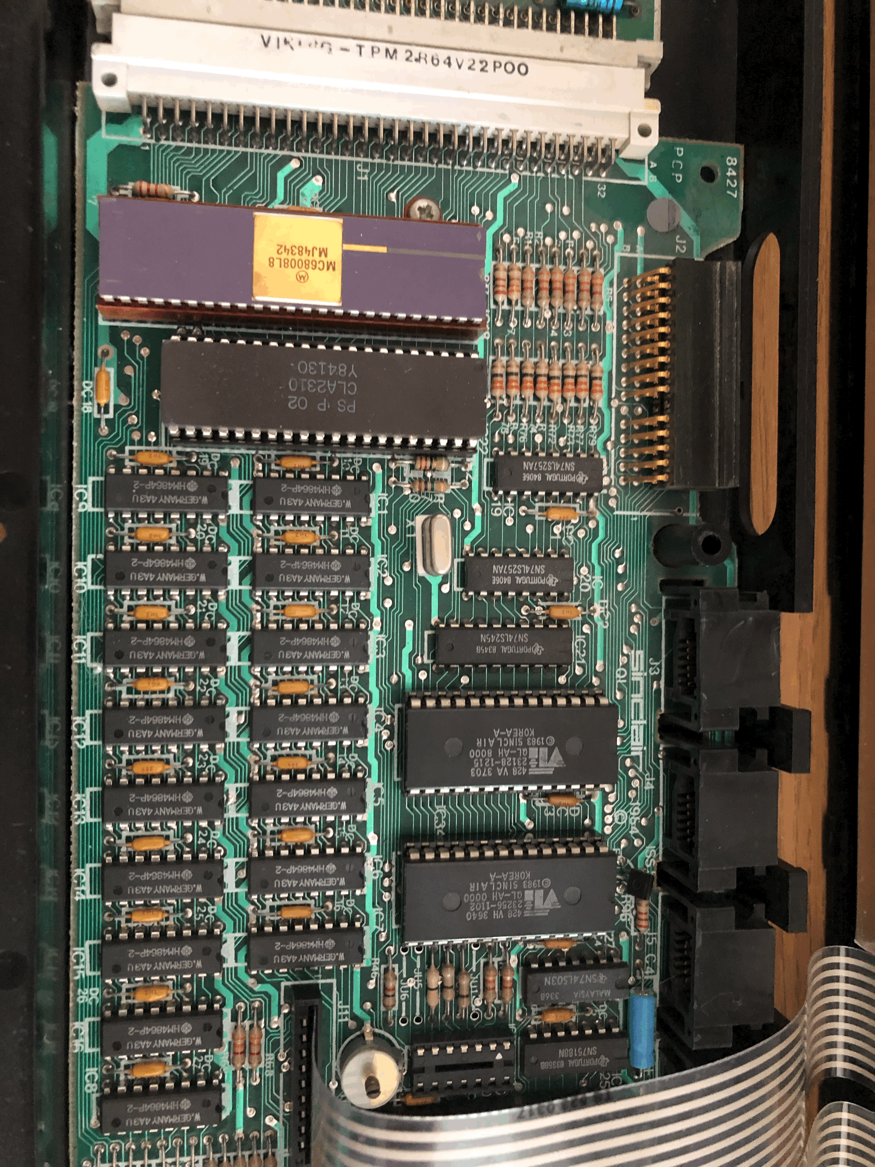

Thanks for your reply. The serial number is D09 015124. ROM chips are made in Korea-A, 1983. I don't know what the motherboard issue is but attach a picture if that gives any info. When loading software I usually get this error message "280821 bad or changed medium". I might have swapped IC33 and IC34, not sure, - would that make a difference?
I also attach pictures with Expanderam plugged in - without it the TV picture is okay.

Looking at your picture of the board. the board issue number is next to the Sinclair name, infront of the SER sockets.
Your board is an issue 5.
The QL Roms are:
QL AH 0000 low rom
QL AH 8000 high rom
The picture shows the roms in the wrong sockets, switch them over to see if that works any better.

The picture shows the decoding IC for the ROM's is not fitted - you have only a socket, this means the board's wire jumpers - actually they are 0 ohm resistors between this socket and the 1st ROM socket - are set for ROM chips and are therefore wired identically - the ROM chips themselves decode for the upper or lower portion of ROM space - one is 32K in size, the other is 16K. Minvera ROM is 48K and is on a board to decode itself correctly - it will work in either socket

No mention of this so is that a preconfigured jumper block that gets soldered in like a socket but contains shorts for required jumpers?Pr0f wrote:The picture shows the decoding IC for the ROM's is not fitted - you have only a socket, this means the board's wire jumpers
Is the resistor mod on the top of the chip required or is it different on a series 5 board and fitted somewhere else?
