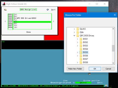

I have been working on my QPC2 DOS drive manager program in EasyPtr.
It still needs a bit of work doing to it, But I could do with a bit of real world testing of selecting new Windows folder paths for the DOS assignments.
I have written a little program in Visual Studio Express, to select the new DOS drive folder. But Visual Studio Express does not produce proper Installation setup files.
So I am just using the Windows .exe file created in Visual Studio Express. This seems to work OK in my Windows 8 ,and 10 systems. It does complain about wanting .NET V4 in Windows 7, But I have not tried installing .NET on my Windows 7 system. I would like to know if the plain .exe file will run OK in most peoples systems.
Unzip the DOSdrive.zip file into a folder on the C: drive named 'QPCfind'
Run the DOSlist_bas program, and click on one of the displayed DOS assignments.
The Browse For Folder window should open, select a folder and click OK
If you Cancel, You will need to press the END key to stop the EasyPtr program waiting.

Re: EasyPtr4
I can confirm that your program combo does work on my W$7-Ultimate system with QPC2 5.01. No .NET issues here but it does complain about the .exe not being trusted. Each time I force execute it AVG steps in and starts analysing and sends a report back to base.Martin_Head wrote:I have been working on my QPC2 DOS drive manager program in EasyPtr.
BSJR
