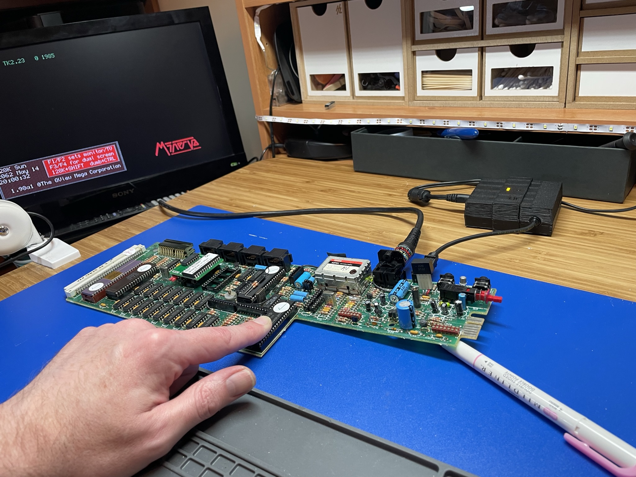

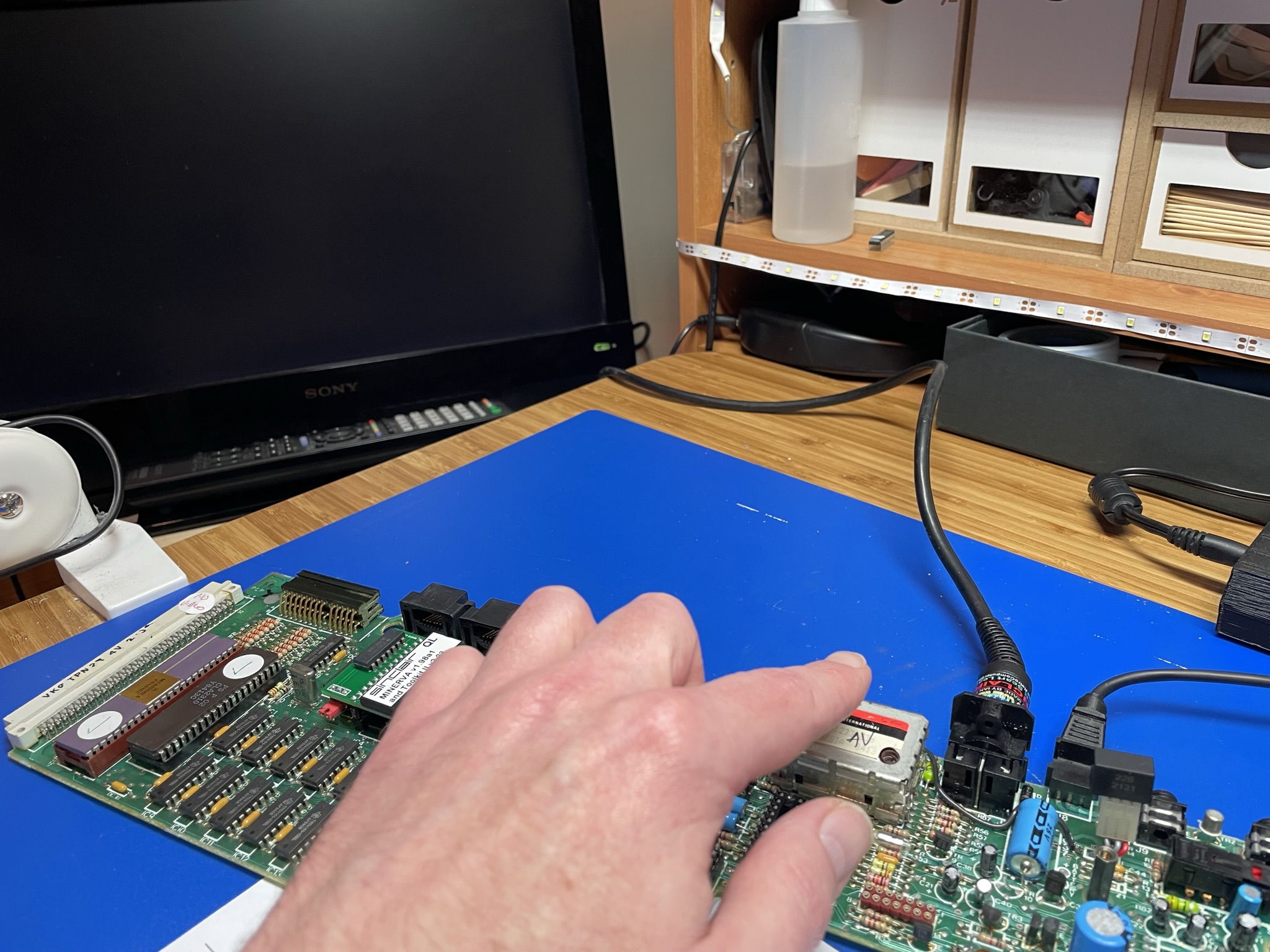

I'm using the can of the RF modulator as the ground hookup for the scope, and as I fumble around I notice a flicker on the TV and the briefest glimpse of the Minerva boot screen.
I quit faffing with the scope and put a bit of pressure on the top of the RF can, and hey presto the signal springs to life.
Lift my finger, black screen
Also if I rest the board on the mat, and bend the right edge up a bit - the signal works
I can't yet see visually any obviously broken tracks / dodgy joints etc on the board, nor have I ascertained if this also fixes the humming cap and dodgy IC28, but at least I know what the RGB issue is. Some contact(s) someplace like a nice little lift from underneath!!!

Turned out to be the RF can. the black shroud was pushing against the bottom of the board, tilting it up at the front of the board and down at the back. pushed the shroud so it's in front of the board itself and all good.
Twist it slightly in the other direction - video works (and buzzing cap and heating up components stop). Push it down towards the bottom of the board, video goes black and buzzing/heat starts. Couldn't determine what it was actually shorting or interfering with, but that was the cause in the end.
