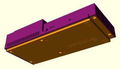

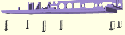

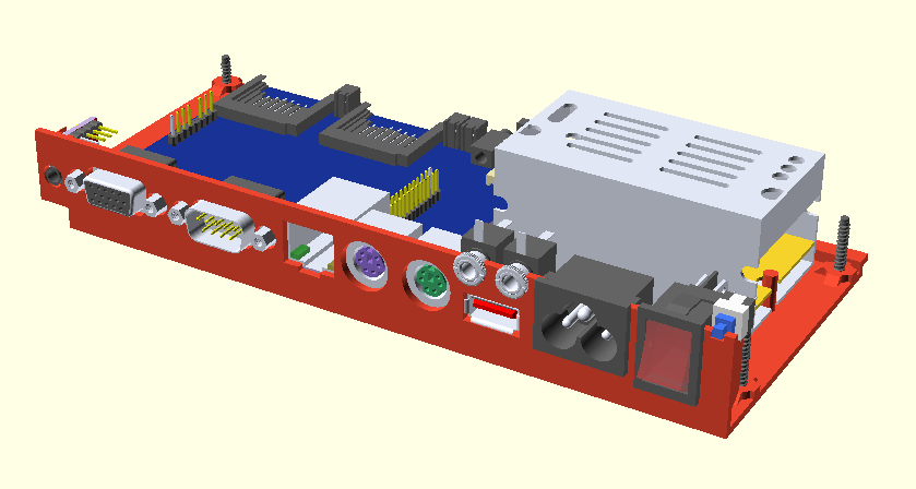

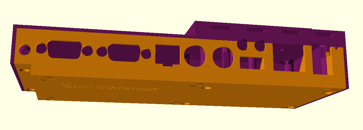

Re: My Q68 configuration
Here are some infographs. The colors of the case are random.
And attached are the STL files. I hope someone can make them successfully.- Attachments
Thank you for the STL files, I got a quotation from Treatstock, which is a 3D Printing Company that outsources 3D Printing work to third party printers, which was quoted as $33.75 (they use US Dollars for payment)
I could get a proto-type print done.

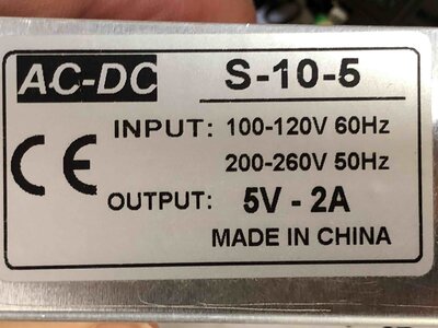

The list of parts indicates the power supply to be :
10W 5V 2A AC/DC Regulated switching power supply for LED Strip Light / Display
Can you tell what the model of power supply is?

It will be interesting to see how it fits together. Mots of the loose components don't seem to have a way to mount onto the 3-D printed parts other than maybe hot-glue?
Edit: maybe what's needed for that case is a daughter board that hosts all the additional components and a simple power supply. The !68 doesn't have too complex of power needs, right? But the case does perfectly match the original QL style.

These are the labels on it:Derek_Stewart wrote:The list of parts indicates the power supply to be :
I don't know more info.

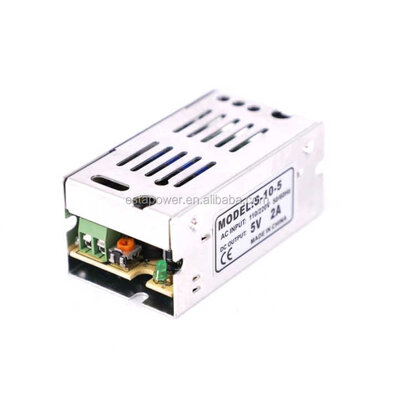

The power supply is available on alibaba.com, £1.74 each, minimum order 5. Maybe a Meanwell power supply maybe a better solution.
