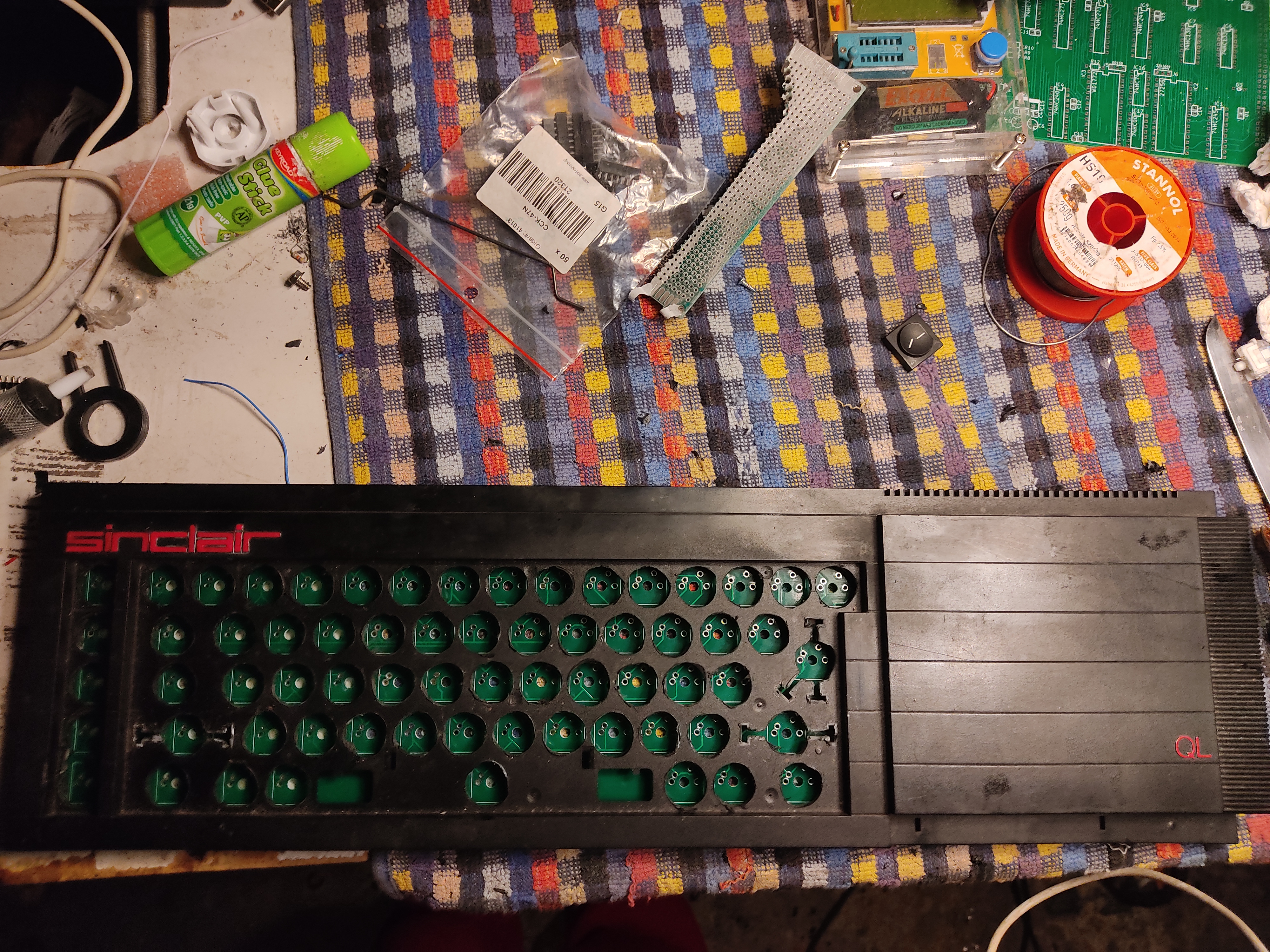

step 1.... remove everithing from upper case of the ql.... and the pilars that not have bolts .....
step 2 tri to match the plate circuit withe center of the keys.....y can use the dremel to center the bolt screws and the pass hole bolts....
step3 try to close the ql....(maybe you must move the plate little up-down-left or right to do this .....)
step 3(i done it with a 16 mm drillbit) remove the circular pilar of the old keys.....) picture 1

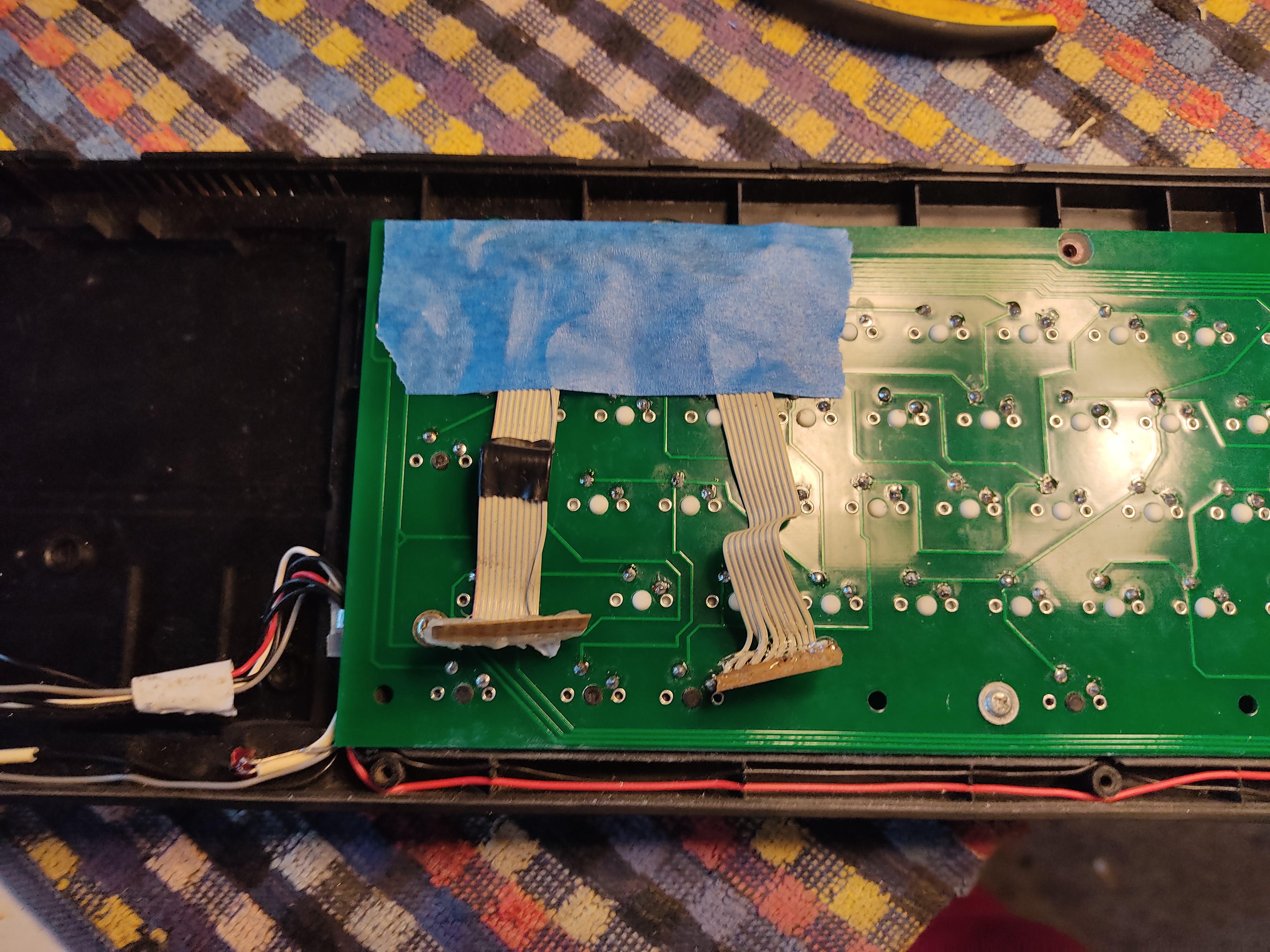

part 4 rebolt the pcb plate and mark the squers that you see removed with file....or dremmel but not brake the bolt pillars... on the center....(ihas 2) picture 2...

then you solder the cherry mx....(because we have not a plate that holds the cheery mx in line..... its allitle tricky to...solder it strait)
pic 3

part 7 take a cable of a disc drive or hdd and cut 9 and 11 wires...
solder the wires (the 11 is all from bottom of the pcb..and the 9 from the top so its difficut to mess the lines)
part 8 to do the edge conecttor i tace a 9 hole pcb vero and a 11...hole vero and i make it thiner to instert to ql keybord conectror
part 8
i found this... and is corrected of this board.,...4 keys is no rigth on the matrix o-9 and 1-3 its inverted)

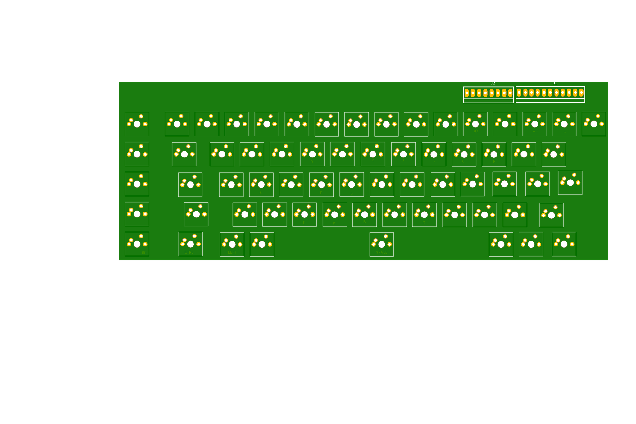

the pcb cherry mx plate....
i say that i found it but i search an jose lendro funt it olso in the past....

nikosdoykas wrote: the pcb cherry mx plate....
Nice job well done. It is needed to eliminate the constant membrane problem. Several people here including me were looking at making a PCB but time is my problem. I am sure you can sell the PCB to some.
