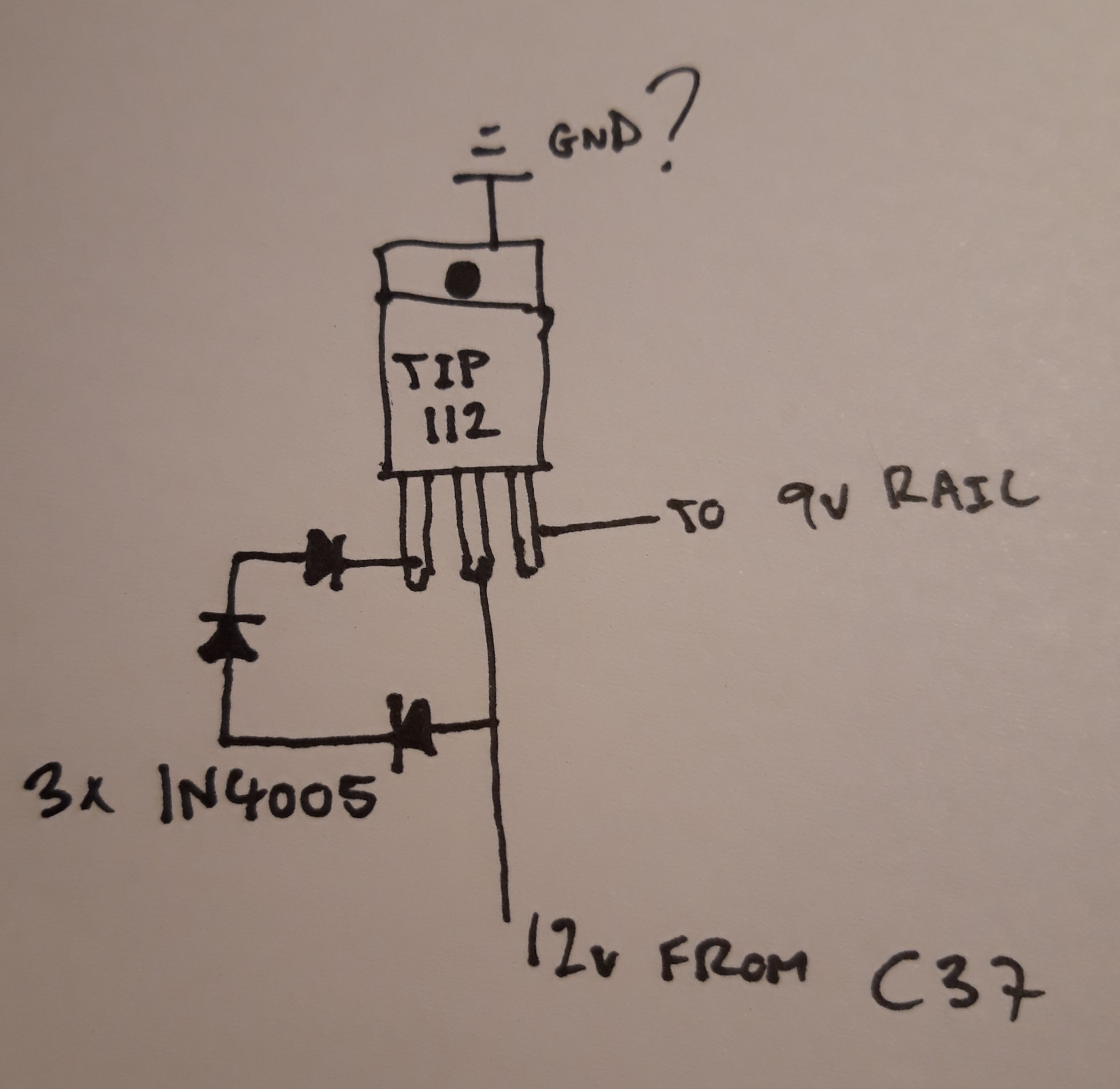

Hmmm, well my 9v seemed steady and good, but there's something odd going on. I removed the TIP112 transistor that was supplying the 9v rail. It's a bit of a bodge by the previous owner. With that removed, the backplane doesn't seem to work at all, in that no cards plugged in are recognised on boot.

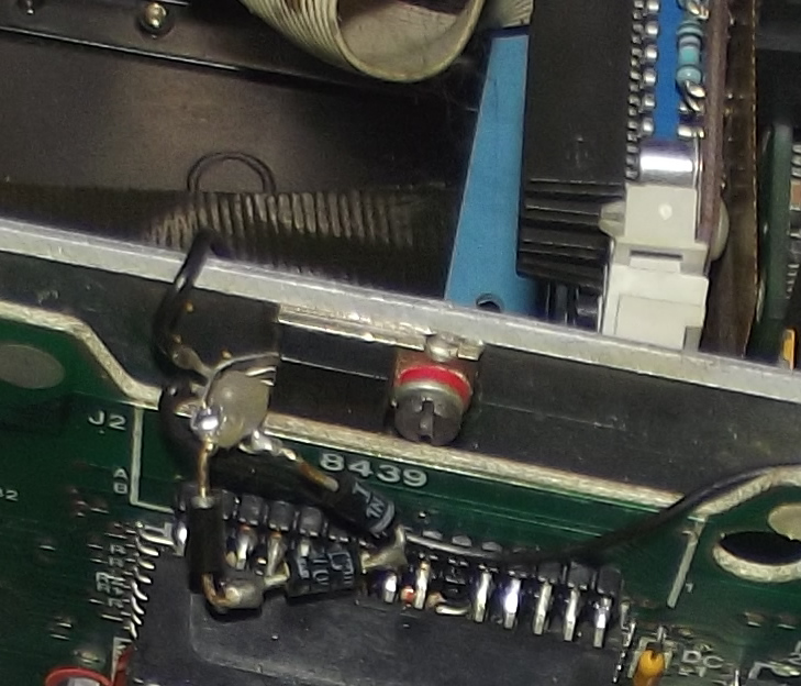

The TIP112 was mounted on a chunk of aluminium, which is grounded, but I don't think it actually should be because now when I re-mount the TIP112 there is a short and the PSU won't even start. There was a plastic thing around the screw so perhaps the TIP112 was never grounded (i'm sure it was touching the alu gnd though). This is my amateur diagram of the arrangement:
There are 3x 1N4005 diodes in series between pins 2 and 1. Pin 2 gets 12v from the anode of C37 on the motherboard. And at pin 3 there is 9v, which goes to the 9v rail on the backplane card.
I assume there must be a better way of getting 9v to the backplane?

the pin outs are B C E in the order left to right - and tab is connected to pin 2 (collector)
More worryingly there is a diode connected between C and E which would provide about 11v to your 9V circuits !

Ignore the comment about the diode - the pdf shows the diode correctly oriented - the piccy on the web has it the other way around.
The 3 diodes act a dropper to drop about 0.75v x 3 - 2.25v with the voltage drop of the darlington pair in the tip112 this will be about 9v on the emitter with the collector at 12v.

Pr0f wrote:tab is connected to pin 2 (collector)
So the tab was never intentionally grounded then as that shorts the 12v input on the collector. That's odd, it looks like it's right against the metal in this original pic, even though the maker did use a plastic washer. I'll have to investigate that aspect further, but it still doesn't work with both cards attached.

Usually when fitting a transistor or regulator in those TO-220 packages - you would use a Mica washer - which are thin and see through -so not always obvious, these conduct heat very well - but will insulate electrically. Also there would be an insulating bush that allows a bolt to pass through the tab without contacting it - you can normally get a kit of both bits. Some newer kits use a silicon material which is a bit thicker, but also conducts heat well.

Chr$ wrote:There are 3x 1N4005 diodes in series between pins 2 and 1. Pin 2 gets 12v from the anode of C37 on the motherboard. And at pin 3 there is 9v, which goes to the 9v rail on the backplane card.
I'm not much of an electronics guy but that looks like a kind of an emitter follower where emitter voltage follows base voltage. Ve = Vb - ~0.6V. The diodes supply the reference V to base: Vb = 12V-3*(Vf of 1N4005) = 12V-3*~1V = 9V so theoretically your 9V rail should see something around 8.4V ? Depending on actual values of individual components.
So, it's kind of a homegrown voltage regulator
