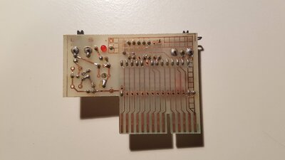

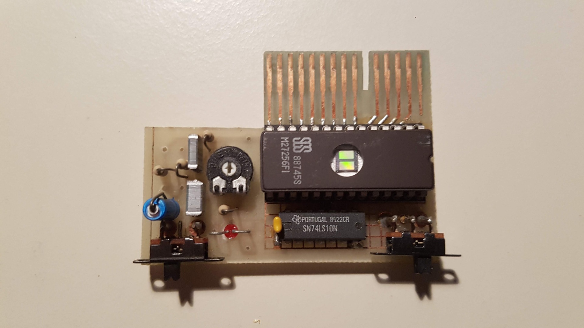

A member of the Sin_QL_air user club has even made a ROM cartridge with built-in cassette interface.
Note the extra LED and 32K EPROM so you can switch between two ROM extensions...
Jan
