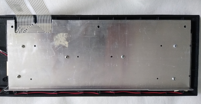

Hi Patrick,
I have sent you the screws as requested.
The keyboard retaining plate should be secured as shown below:
