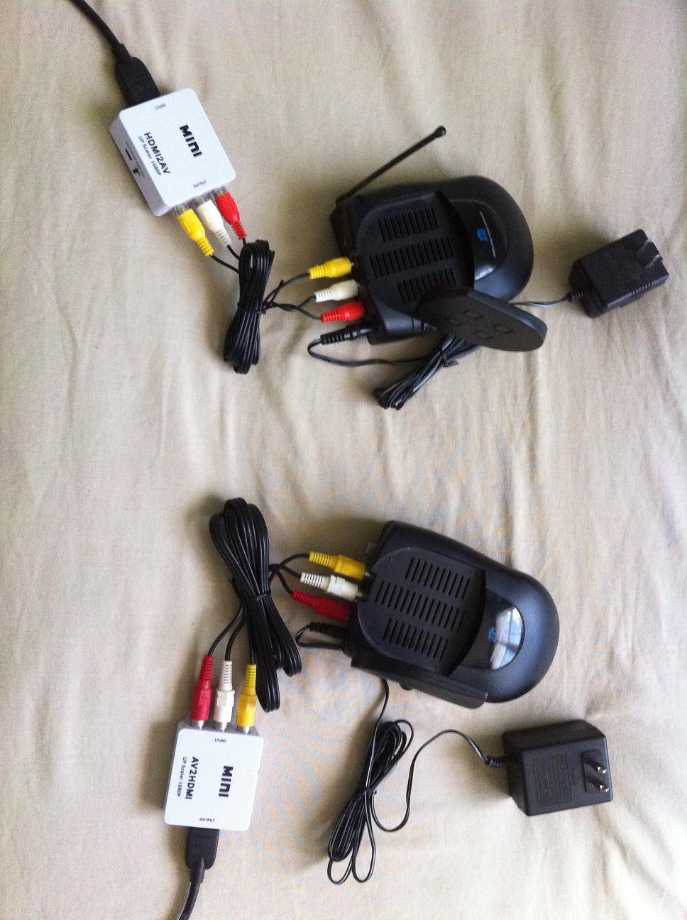

I did as the article suggested and used an upscaler and downscaler to create a stable composite signal. Not sure if the image degrades a bit since the jitter made it bad but I don't think too much. The picture below shows the two scalers I used -- note that I was testing them last year at school to see if I could take an HDMI signal, convert it to composite and transmit it via X10 over the air to an X10 receiver and convert it back to HDMI, which worked (though the HDMI signal obviously degraded). So I used the same two scalers this time and reversed them, Composite-to-HDMI-to-Composite, to get it to work
