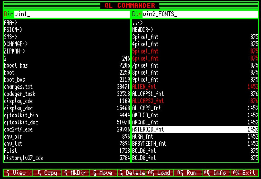

As this is my first QL program in the last 30 years and I will probably have more questions to ask - and will need some help to compile it.
But it is fun to write it !
The navigation is ready - now working on commands and viewers.

Screen dump looks good! Good luck finishing that program. Let us know how it goes.
