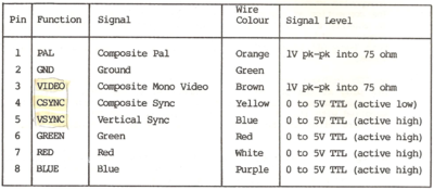

Not quite - the QL definitely provides TTL-level output on the RGB (and V / C-Sync) lines.

Pr0f wrote:I believe the RGB outputs are 1V video on the 8 pin connector - as there are resistors on the motherboard between the socket and the video ULA.
Actually not - seems the resistors are for the RGB encoder chip for composite / UHF signal output - the circuit board shows these are coming straight from the ULA - so assuming 5V ttl signals

Posts: 2816
Re: Naive question about SCART connection on TV
Source: QL Service Manual
