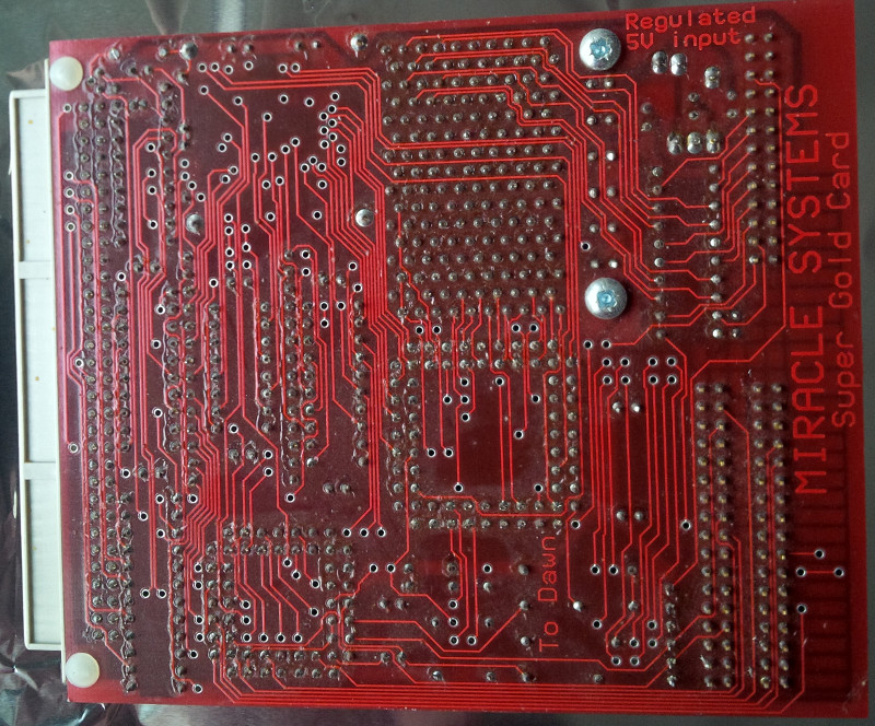

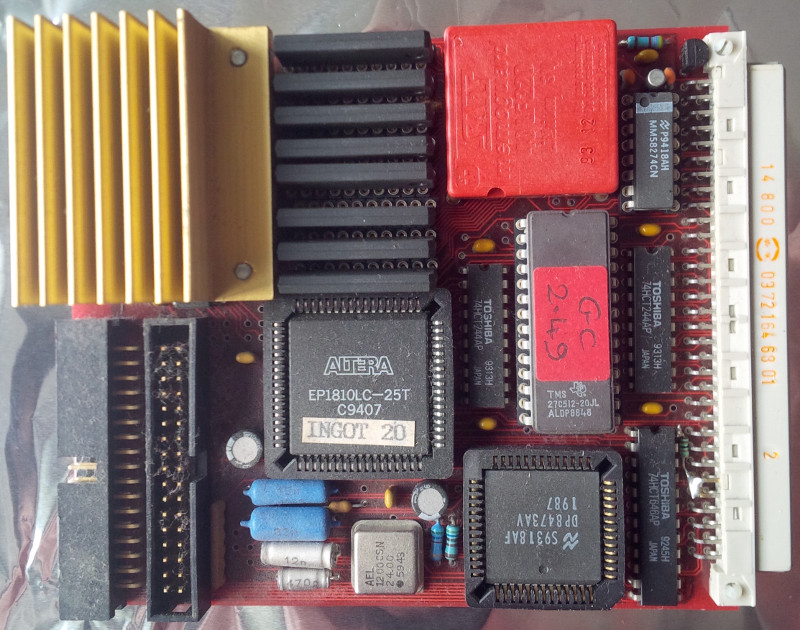

It is one of the first produced, I got it from the hands of Stuart Honeyball himself during a show, maybe in 1993 (I have not found the invoice, but I will look again for it). I used it without any problems with my 1984 JM QL upgraded with Minerva for about 12 years. Afterwards it was stored in my cave for about 12 more years. This is ridiculous when it is so rare. Hereunder 2 pictures of this card filled with 12 years of dust. I don't want to test it here, because I do not want to blow up either my QL or the Super Gold Card after so many years of sleep.
I understand that Tetroid and Dave could reverse engineer it to produce new batches, and Marcel could use it to test software. Hence I would send it to Tetroid. He would look at it at will, and answer all of Dave's questions. If Dave still needed it, Tetroid would send it to him. And then it would be sent to Marcel. If it still works after such a journey, then Marcel could pay whatever he thinks it is worth so that he would be the new owner, as I saw that he insists on this.
What do you think of this plan?
Arnould

Did anyone have the abel, equations or JED files for the SGC? I thought there was mention of it on this thread....
The basic building blocks look to be similar to GC card, in that there is an FDC, 64K eprom, an RTC chip - these are common to both GC and SGC - I suspect even to the addresses used.
The Ingot chip is obviously running a different program and also providing a parallel port. The processor is 68020 rather than 68000. Most of what's different will be within the 'ingot' chip.

Arnould wrote:Hello from France,
I have an unused Super Gold Card that I would send to either Tetroid to the far east, or Dave to the far west, or to Marcel, Germany.
Arnould

Arnould
Posts: 10
Joined: Thu Feb 01, 2018 11:37 am
Re: Miracle Super Gold card
Post by Arnould »
Hello Tetroid (Vitaliy),
So Dave does not need a SGC, my mistake because of a message about a file with equations above. And Marcel informed us on his blog that he can wait for your clone to test his new developments.
So this Super Gold Card is for you.
About price: what about sending me one of your fully workable clones of this card when available (I do not wish to test, reprogram chips etc..)? So if it is broken after 12 years or it never arrives because of the post for example, no problem with money :) I even may get a better product as payment eg SGC clone with 8 or 16 or even 32 MB of memory instead of 4? Your decision.
One question: do you think that I can take the heatsink away so that the parcel will be lighter, or is there a potential problem of breaking the card? Do you have an equivalent heatsink if I take it away? I only see 2 screws to remove to unmount that heatsink.
Awaiting your answer.
Ah, did I mention that I find what you do for the QL community incredible? A sort of a miracle in fact. Same for Peter and Dave of course but they are long term QL enthusiasts whereas I never heard of you before I looked at this forum after about 6 months.
Arnould
Posts: 2816
The heatsink is very light aluminum. It weighs about the same as a single IC. The way the beard is assembled, it's kind of fun to get it back together. I suspect the first thing Tetroid will do is remove the heatsink and replace the 7805 with a buck regulator anyway.
It would probably be good to let him see how it was assembled with the heatsink, because it was an interesting arrangement.
