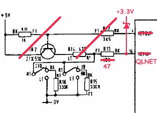

The picture below shows the Q68 network wiring in comparison to the QL schematics. Looking back, I should of course have added the few components directly on the Q68 PCB. But at design time, it seemed unlikely that someone would write the driver. Could you solder that?
QL NET seems still the best connectivity with the original QL. From Q68 to Q68, SERNET at 115 kBaud over Nullmodem cable is fine. But on the original machine, SER remained problematic.

So from the diagram does that mean your network pin is bi directional, and only the termination resistors are required ? I see the schottky diode to VCC to take positive going transients, what rating does that have to be to cope with the original QL network being referenced to 5V VCC ?Peter wrote:Sounds good, and Q68 SMSQ/E will be open source of course.

Yes the line is bidirectional. The clamp diode to 3.3V should be schottky. In combination with the 47 Ohms series resistor, it protects the 3.3V logic of the Q68.
Clamping to 3.3V with the two 47 Ohms series resistors at each end should not have any negative effect for the QL. The input voltage level requirements are met. One or two Q68 inside an original QL network caused no problem here. Viewed on oscilloscope, this "soft" clamping even seemed to improve signal quality a little when cables were long.

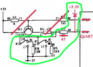

OK, we're on... Just to be clear, the components still needed include everything in the green mark-up I've added below?
Do you have any preferences/existing ideas for how we would make the connection to those pads on the Q68 PCB? For example, we wouldn't want to block further expansion by hogging the pads-area...
M.
