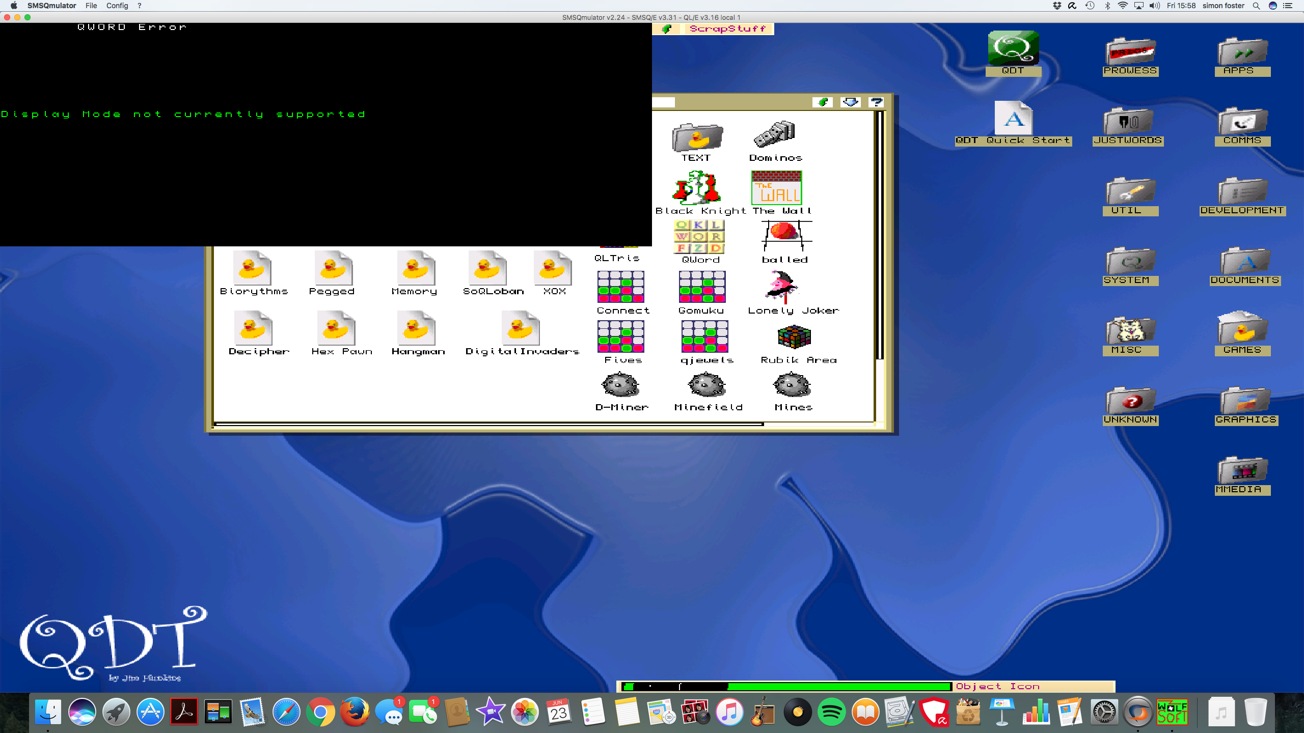

Hi can any one help me it would be very Good to make SMSQmulator High Graphics compactble so when you run QLE/QDT you can play games like QWORD OK Thanks Simon Foster

SMSQmulator does high level graphics. It supports up to 24-bit colors. Are you running QDT and not seeing the full colors? Do you have the emulator set to use 24-bit colors?

Hmm - that is interesting - the screenshot shows SMSQmulator running in hi-res graphics.
QWord is not running - it is struggling to identify the graphics mode. Does SMSQmulator report the mode as MODE 32 (a la QPC2), or MODE 33 (a la Q40) - it might need configuring.
It could also be that it is struggling to identify the machine mode!

SMSQmulator is Machine 20 running in colour mode 32 like QPC2.RWAP wrote:Hmm - that is interesting - the screenshot shows SMSQmulator running in hi-res graphics.
Rich
The example is running in a stretched display, maybe that is giving QWord a headache.

Ah - that explains it - QWord needs to be updated to equate MACHINE = 20 (SMSQmulator) with MACHINE = 30 (QPC2)BSJR wrote: SMSQmulator is Machine 20 running in colour mode 32 like QPC2.
Bob
I shall do this when I get chance.
