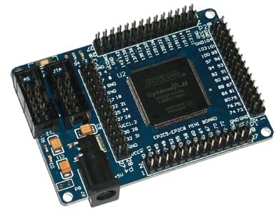

The advantage of these CPU is that they are very low cost and a very low cost FPGA can be used as well.
I still have 25 of these
and I am familiar with the development board that Grant Searle uses for his designs:
http://searle.hostei.com/grant/Multicomp/index.html
Its available for 15USD including postage from china.
I have already made a ZX81/ZX80/JupiterACE Clone with this board where it plugs in to reduce work and cost.
Kind regards
Paul

I can understand this but the CPLDs are developed with the same software as the FPGA.
And its easier if your code doesn't have to be split up in multiple devices.
You will also need an IO-Processor for your QL.
By the way, do you know a source for those EPM7160SLC?
Cheapest I found was US $15,58 from Ebay/GC_Supermarket. That's more than the FPGA development board which has 5000 Cells in place of 160.
I'm always looking for an affordable source for these EPM7160SLC as these are the largest I know with PLCC casing and 5V compatibility.
