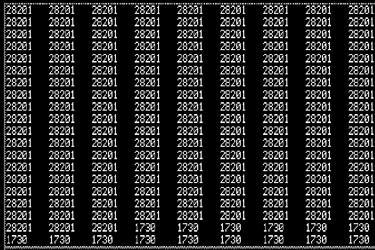

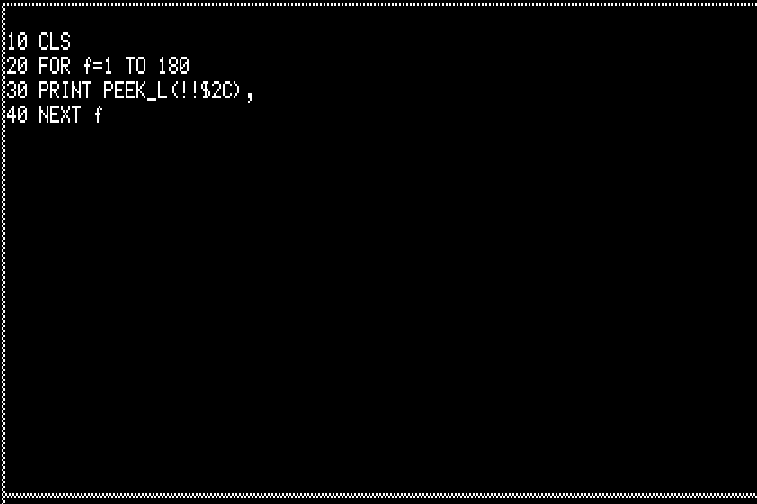

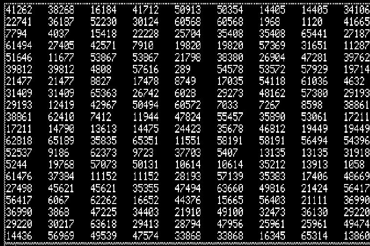

OK this is the program used to printout the numbers
Its on a laptop using Q-emuLator with SMSQ/e loaded and running in DISP_COLOUR 0, 512,256
The first set at the program running at QL speed, the second at GoldCard speed, the last is at Full speed. I can understand the repeated numbers as the PEEK sample must be acting quicker than the actual time updating, but at slower speeds there seems no logic to the numbering sequence.
Any further clues?, am i doing something wrong?
