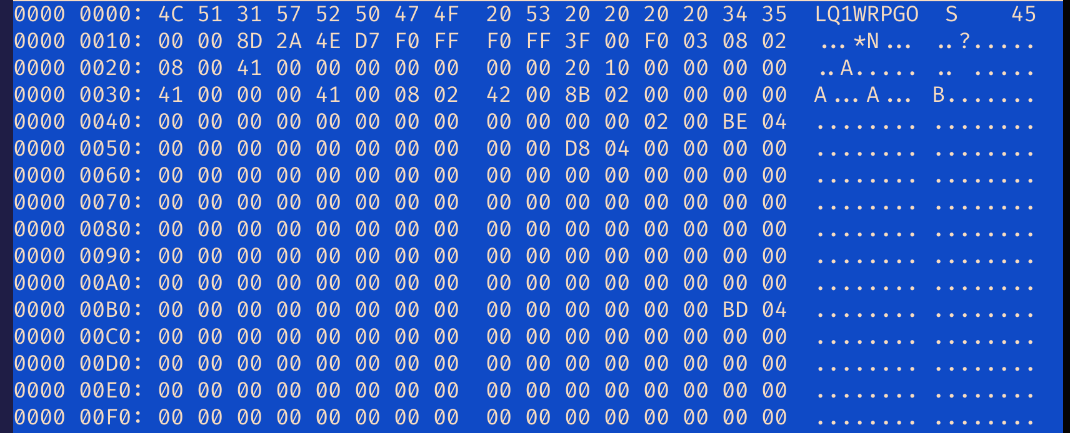

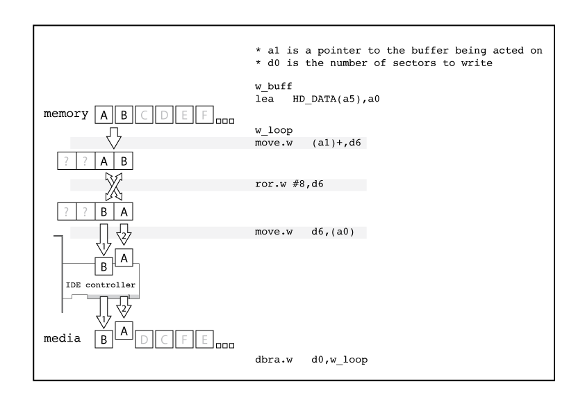

I've been wondering why QubIDE images written by QDOS Classic under emulation end up byte-swapped.
Nothing jumps to mind so I took a look at the original unmodified QubIDE sources.
The driver correctly byte-swaps word data before sending it to the IDE controller, because the controller expects word data to be little-endian.
I may be missing something; I had to scribble the logic down to picture what was going on (tidied up below).
To me it appears as if the data may well end up being written out to the end media byte-swapped.
I'm wondering if the data buffer should have been byte-swapped; simulating a little-endian source; before being byte-swapped and written to the controller; negating the need for byte-swapping the data buffer in the first place. To be honest, It's a bit mind boggling.
Anyone got any views on this?
...and has anyone ever dumped a true QL QubIDE formatted disk to a hardfile?
I'd be interested to see if it starts with "LQ1W" instead of "QLW1".

Wow, that was quick.
I guess that means that the byte-swapped hardfile is the true QubIDE format.
Re: QubIDE media layer query
The usual mistake. One can not use a little-endian system to directly read big-endian data on a 16 bit bus.
A QL QubIDE formatted harddisk, just as a Q40/Q60 QubIDE formatted harddisk, reads "QLW1" on big-endian hardware.

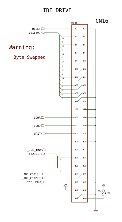

I am pretty sure the IDE port on Amiga is little endian.
So natively the Amiga will see the same byte swapped image as a PC.
Yes, it would be exactly my next step to try and find some Amiga IDE schematics.
It's not easy to see due to the poor schematics, but the Amiga IDE interface does indeed byte-swap as Graeme suggested:
https://www.amigawiki.org/dnl/schematics/A4000_Rb.pdf
Atari and Q40/Q60 interfaces do not byte-swap.
