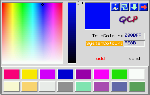

Re: QD for Basic and other editors
There is an update version of QCP on my site:Tinyfpga wrote: Tue Nov 26, 2024 9:39 am Thank you for suggesting qcp160 it solved my problem. At first I was unable to UNZIP it because the UNZIP algorithm I use needs the toolkit Qerr_bin, that I had not included in my re-install.
My next two questions are as follows:-
My new QDs have a, barely visible, light blue flashing cursor. My original QD has a bright red one. How can I change the colour of QD's cursor?
Where can I find out more about SMSQE's colour codes, names, etc ?
https://home.hccnet.nl/b.spelten/ql/qcp.html
QCoCo, also there, can be used to check/change the System Palettes.
But QD has a few places (e.g. F9 - Replace menu) where the old Colour Ways prevail, that need to be fixed.
Finding the right mix of background and cursor colour can be a challenge as the latter seems to be fixed in QD and doesn't change with the System Sprites.

Are you suggesting that the colour of QD's cursor can not be changed or that it is difficult to do?BSJR posted:-Finding the right mix of background and cursor colour can be a challenge as the latter seems to be fixed in QD and doesn't change with the System Sprites.
Are you willing to elaborate?Derek posted:- QD will use tge WMAN2 colour setup, which can be changed in a boot file.
Documentation on this is very sparse, but Marcel did two files with QPC2 to show how to change the colours in a GD2 environment.
Where can I find the two files?
