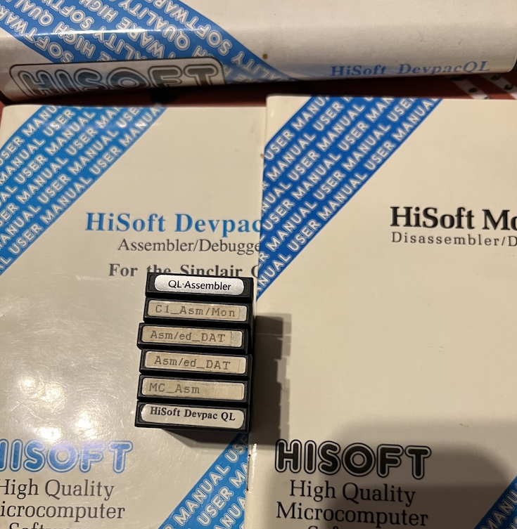

I haven't re-felted these as yet, but I wondered if anyone could help identify what should be on these MD's, based on the labels (and do they look original), please?
Although I've got the Monitor manual, I assume I'm missing the software?

MonQL should have:
boot
clockj
MonQL
MonQL_ROM
Devpack seems to have:
ASM
clockj
GenQL_Boot
library
linkinfo
MonQL
MonQL_Boot
qdosf
readme
I will email these over. There is also GenQL - I have v1.30 and v2.00 of the software.
QL Assembler is the GST Assembler
C1_Asm/Mon is the Computer 1 Assembler and Monitor
Not sure what teh other three cartridges are

I'll try re-felting the 3 mystery MD's and see if there's any clues on them

Have come to the conclusion that all, except GST & DevPac, are just copies
The copies are totally corrupt apart from C1 and MC_ASM both of which are partially corrupt, so will try re-formatting them all to re-use as blanks when I need some more
The MC_ASM contains the following, if anyone is able to identify it though please? (just out of interest)

Mystery solved I think, the listing looks almost identical to my Metacomco assembler MD
