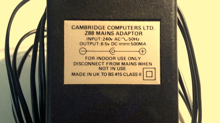

The specification of the power supply. It should be 6.5v 500mA, maybe 6v may do it.
But check Rakewell
http://www.rakewell.com/z88/z88hardware_p.shtml
Posts: 1558
Re: Z88 power supply
I'd err on the higher voltage side - the Sinclair PSU puts out about 6.5V, but 7.0 or 7.5 Volt, but the polarity is important! There is NO protection in the Z88 for reverse polarity - so check the documentation. From memory (and please don't rely on this info) it's the opposite of most common supplies.
Actually Rakewell site says centre positive - so that's normal for a lot of supplies.
