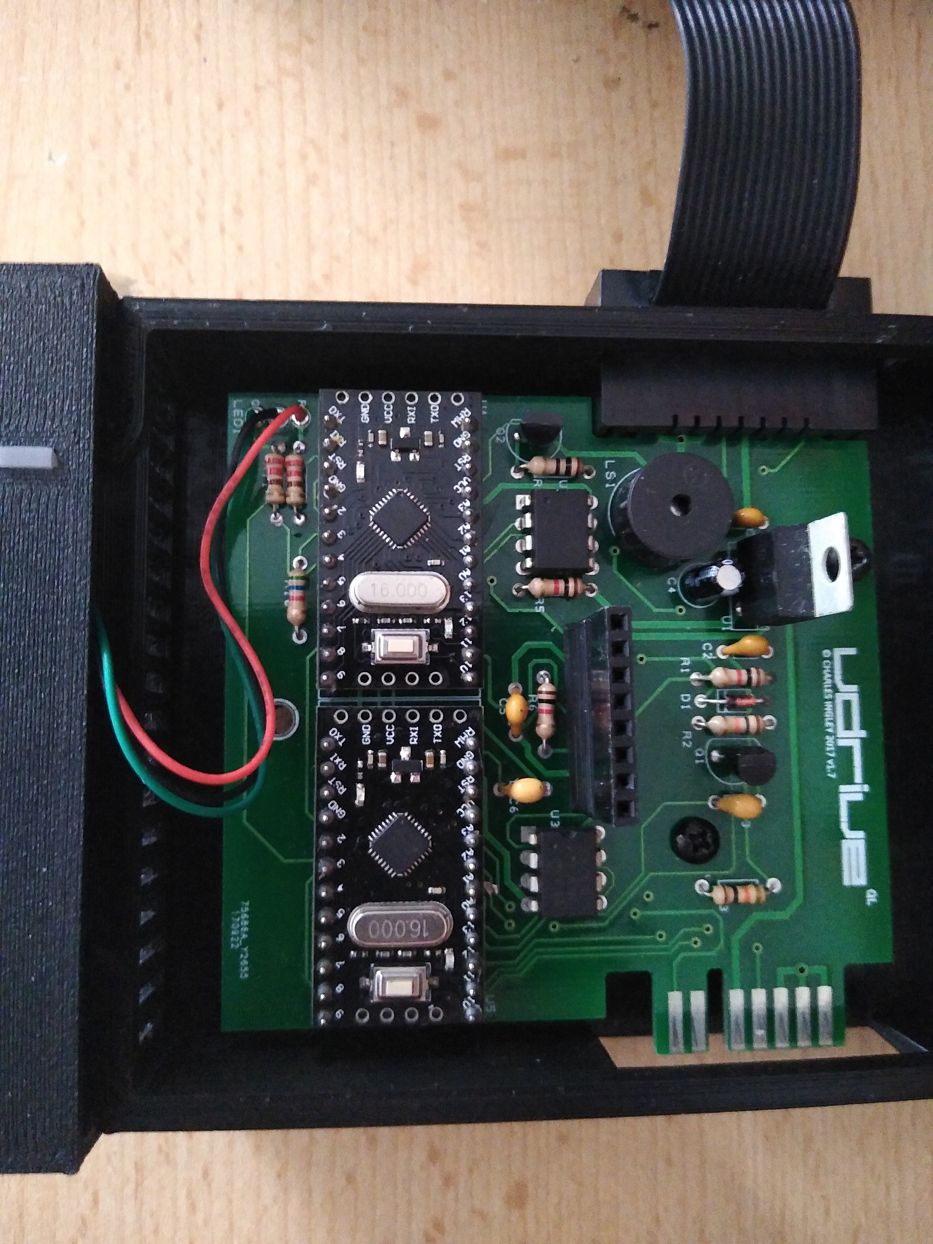

I finally got time to fit the vDriveQL into Charlie's new case, since I used to use it in a Spectrum Microdrive Case.
Here is a photo of the reset switches on the vDriveQL: The Reset Switch is at the end of the Arduino board in front of the Capacitor.

Thanks for showing me what it looks like. Was it hard to take the plastic cover off of those two boards?

Not really, the cover was designed to sit on top of the circuit boards soldered to the main board.bwinkel67 wrote:Thanks for showing me what it looks like. Was it hard to take the plastic cover off of those two boards?

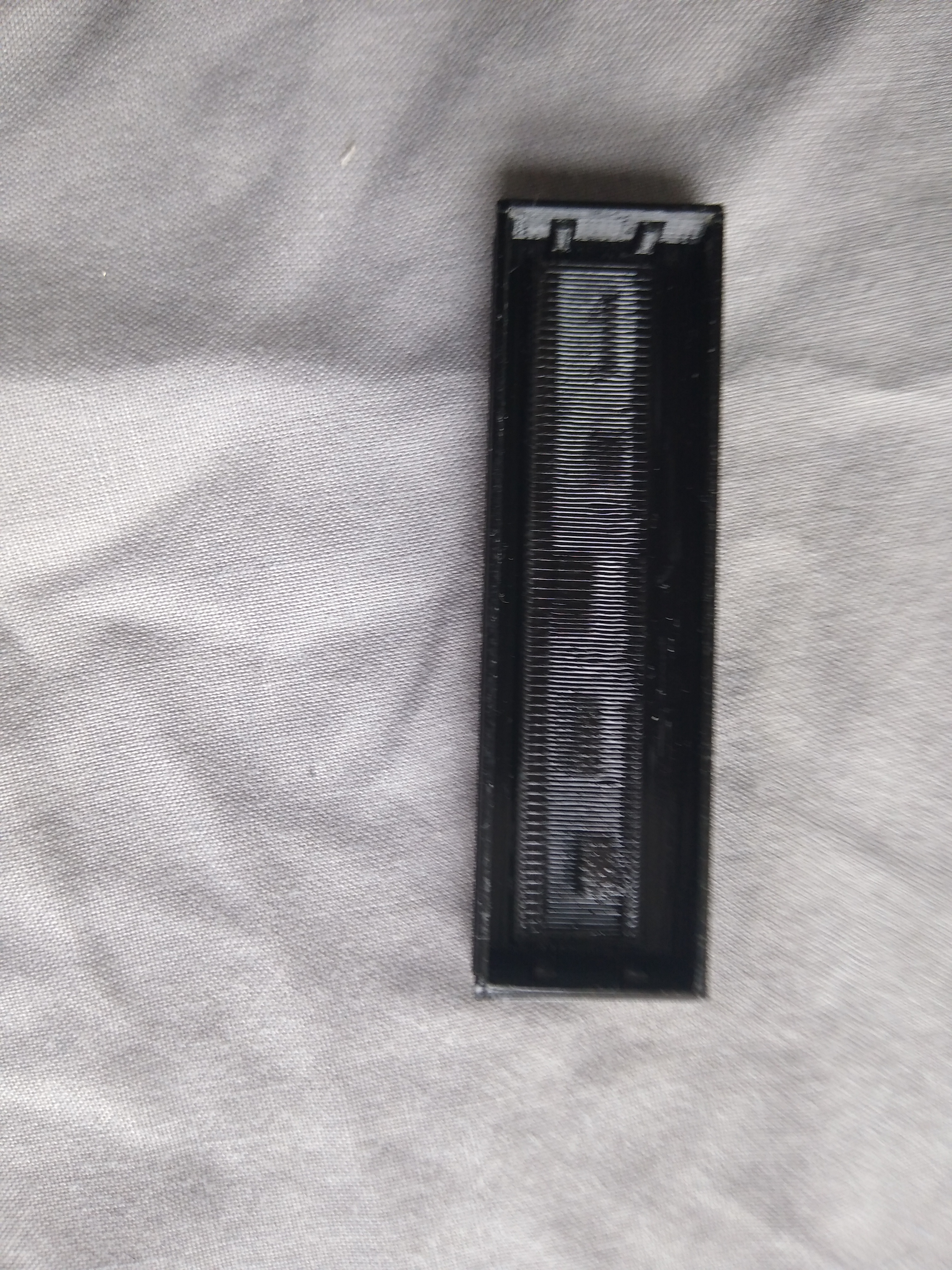

My cover comes off all the time. But just gently lever the plastic cover from one end:

Thank you. I got my cover finally off. It was glued on both ends but with gentle pressure it eventually came off. Unfortunately my boards don't have the reset switches though presumably I can just bridge the contacts. Waiting to hear from Charlie to confirm before I give it a try. Hopefully that will fix it, otherwise Charlie postulated that the left board has gone bad.Derek_Stewart wrote:My cover comes off all the time. But just gently lever the plastic cover from one end:
I also tried to gently pry the boards from the main one but they aren't budging. Don't want to force it. It seems they ought to come apart but maybe it's all soldered in there.
