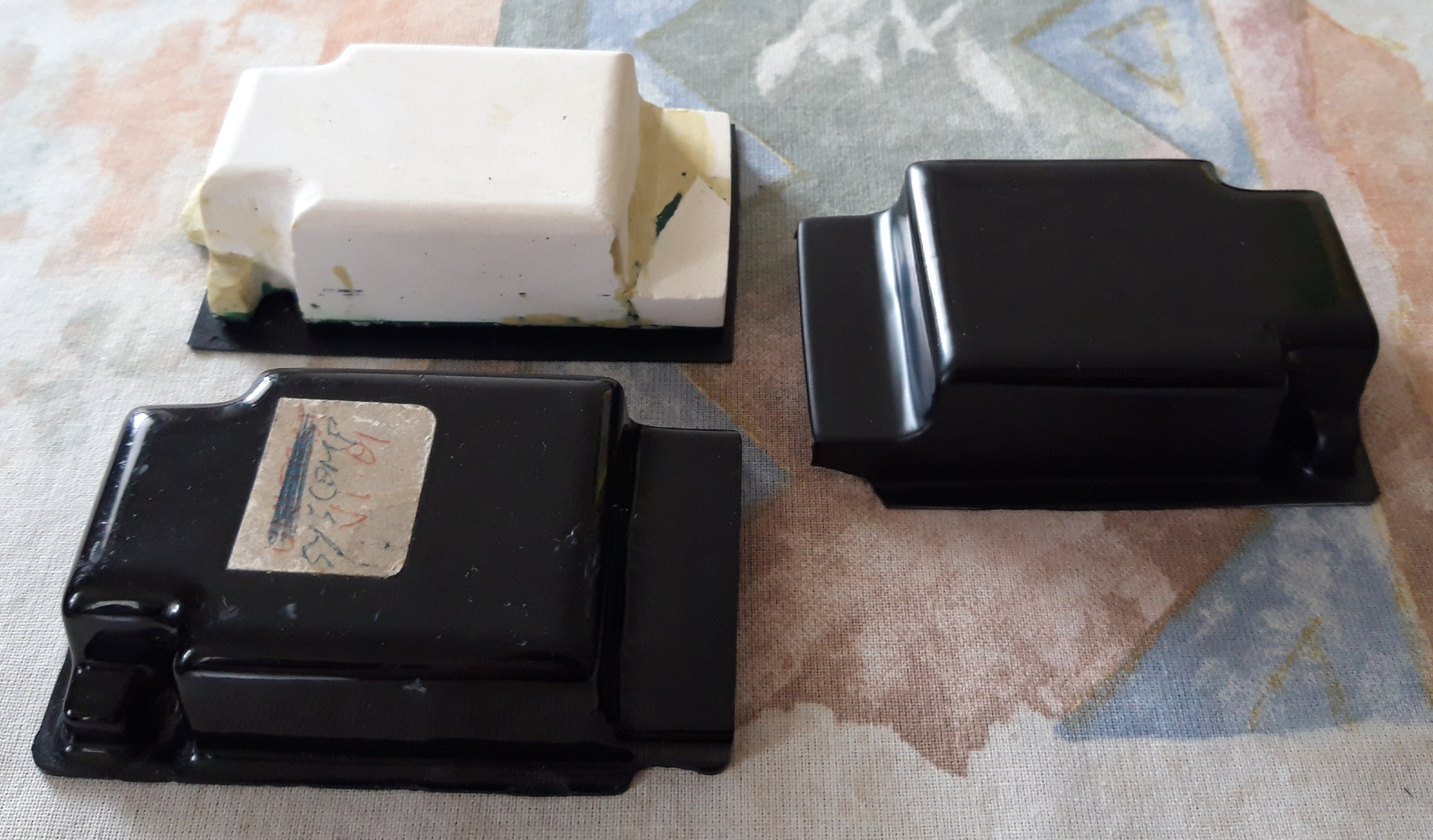

I got a vacuum forming machine (a small model aimed dentists). Plastic sheets 130x130mm fit inside and that's just about enough to practice replicating some original ROM dongle/kludges, which are of course vacuum formed in the first place.

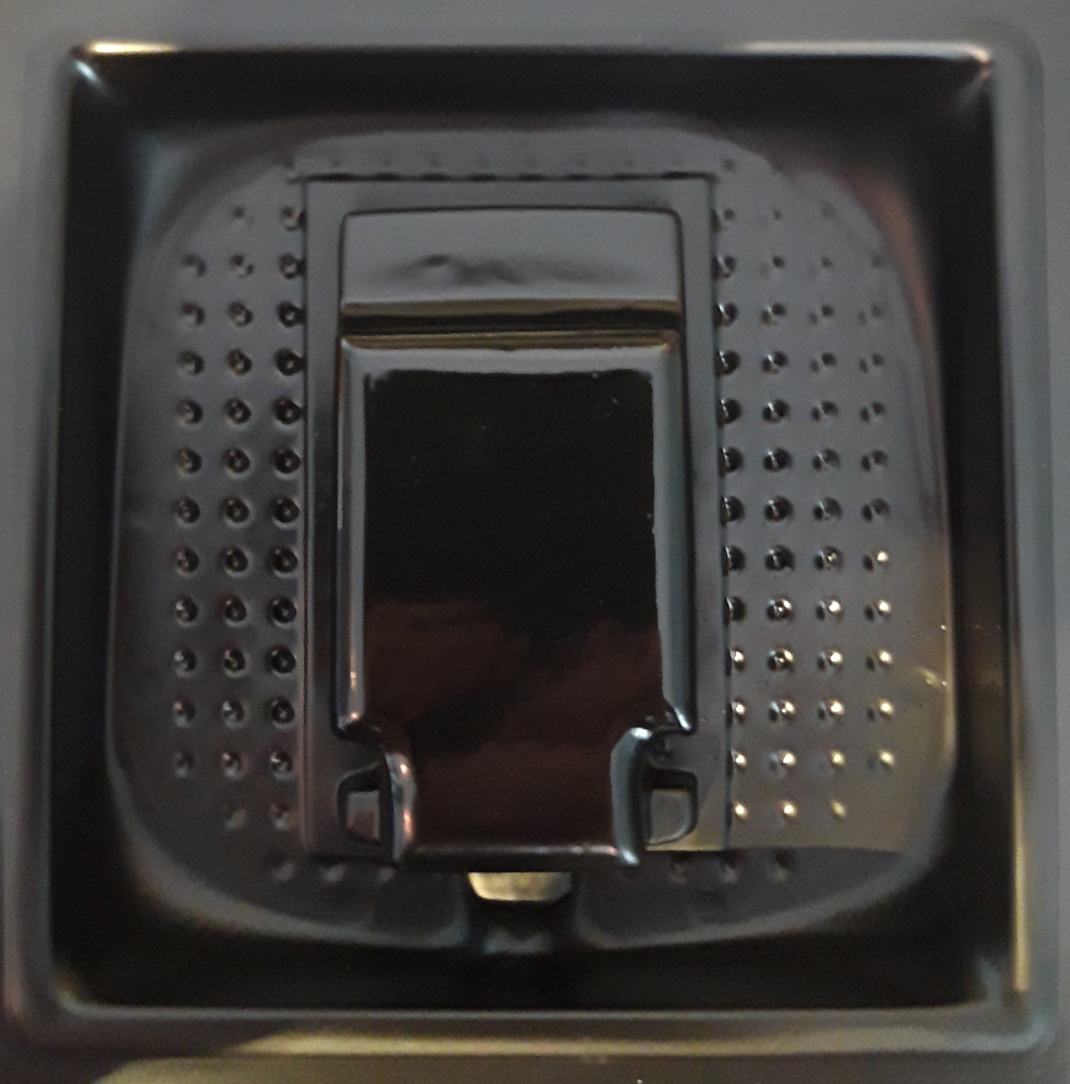

Making the master from the inside of a real dongle was quite a bit of work. I thought I could just pour some plaster in the original and let it set but it wouldn't come out without breaking it. So it's made of plaster, epoxy putty and glue and involved lots of shaping, filing, grinding, sanding etc. It has a plastic base to add strength made from an old floppy disk. It's not perfect but is very close to the original and the original ROM PCB certainly fits inside as it should. It's not quite as thick as an original but I'm still perfecting my vacuum forming skills. I used sheets of ABS - no idea what the original plastic was. I need to also make up the base part.
Pic above shows one before cutting out.
Mould at the top (or whatever the technical term is for the 'master' used in conjunction with vacuum forming), a real dongle under it and a copy on the right.
Unfortunately it's not big enough to create a housing for my Q68.

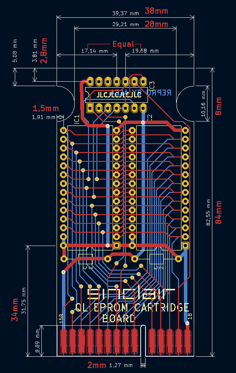

If you want to check your PCB size specs:
The original board is 84mm long by 38mm wide.
The circular cut-outs are 8mm diameter at the widest part (the edge of the PCB) and are 5mm deep into the PCB, therefore the distance at the narrowest part of the PCB from one cut out to the cut out on the other side is 28mm. The highest part of the circular cut-outs are 5mm from the upper edge of the board (this is actually slightly different on both sides - it's a little wonky).
The slot-key gap at the bottom is 9mm long and 2mm wide. From the edges of the PCB to the centres of the nearest through-holes for the EPROM footprints is about 1.5mm. From the bottom slot edge of the board to the closest EPROM through-hole is 34mm.
Pins 4 & 5 (and also 10 & 11) of the 74LS00 straddle the centre of the PCB and the 74LS00 pins closest to the top edge are 2.8mm from the edge (measured from the centre of the holes).

OK, not bad, my error is about 1mm in some places, I put the dimensions in red over the mine, is correct?
Posts: 1400
Re: Vacuum forming dongles
Yes that looks right.

OK, yes files are acording your measurements, there is a small diference about 0,5mm in some dimensions, to match the grid of the kicad software.
In any case I upload to github a file: QL_ROM_Cartridge_original__Assembly.pdf that you can print at scale 1:1 and check if is valid.
I wait for your feedback.
