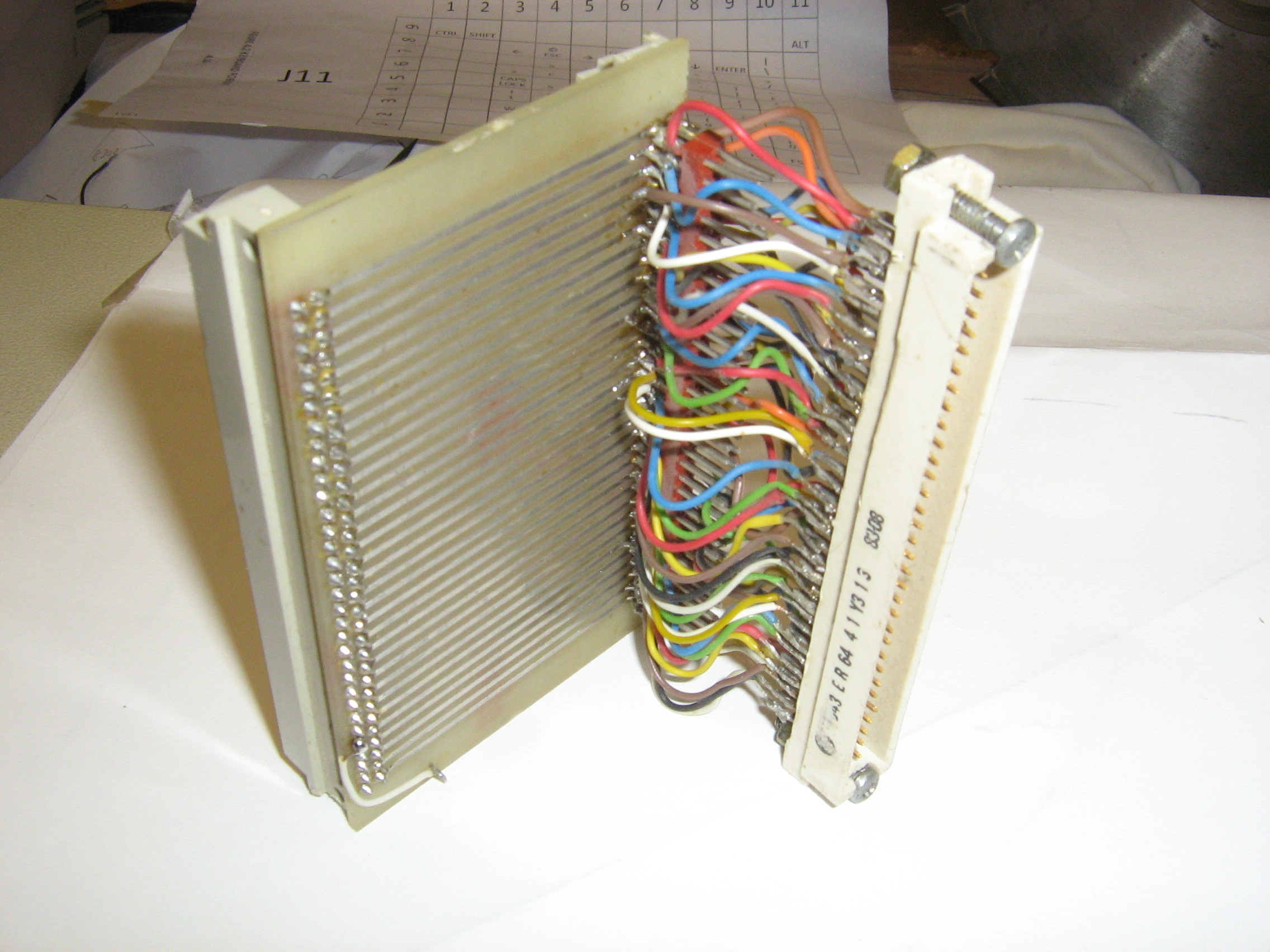

My rekindled interest in my QL is turning into a bit of a trial. ( Could be said to be normal for me, by someone!!)
20 yrs ago I had a pretty good setup.
QL + the Medic i/face + built in to a box with 2x floppies + hard wired 'real' keyboard to modified membrane connectors+ battery backed clock. Failed m'drives removed.
Plus Qjump Eprom programmer.
I bought a backplane and after some trouble had the whole lot working together.
Many hours of fun burning eproms when playing with the OPD.
Looked a bit of a tangle but it did work.
After my hiccup pulling the ROM cartridge out I swapped the 8301 for another and found they both worked.
More fiddling got me past the memory check but to a white screen.
More fiddling and I had the QL up and running half the time with no clue as to why only half the time.
At this point it's a bare QL.
I think there is a problem with either the power in socket or the 78S05 socket/chip. Will replace.
MOVED to a backup QL which starts up every time.
Works with the backplane inserted.
Works with the Medic i/face inserted but NOT both.

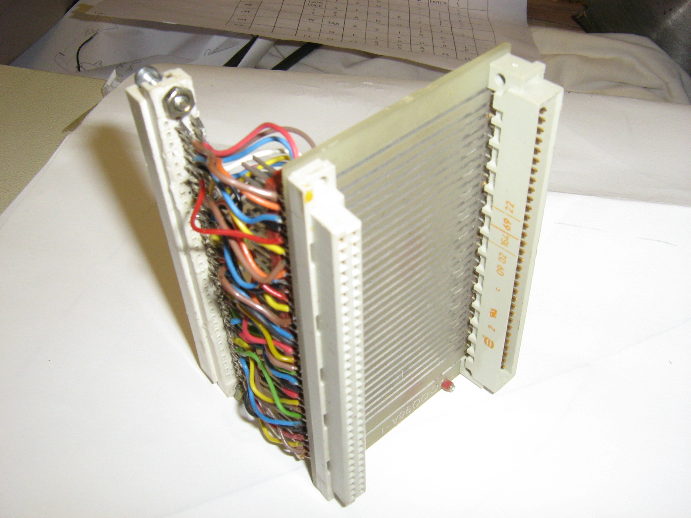

The backplane is pretty messy but did work for years.
Went over it with a meter and 'ha!, found!' it a couple of times, but no luck.
Also, I don't remember why at all, but I've run a wire from one pin on the backplane to either ground or one of the other pins on the 7805.
I think it's the ASL line. The L means Low so I'm wondering if it needs to be on 0v?
Question.

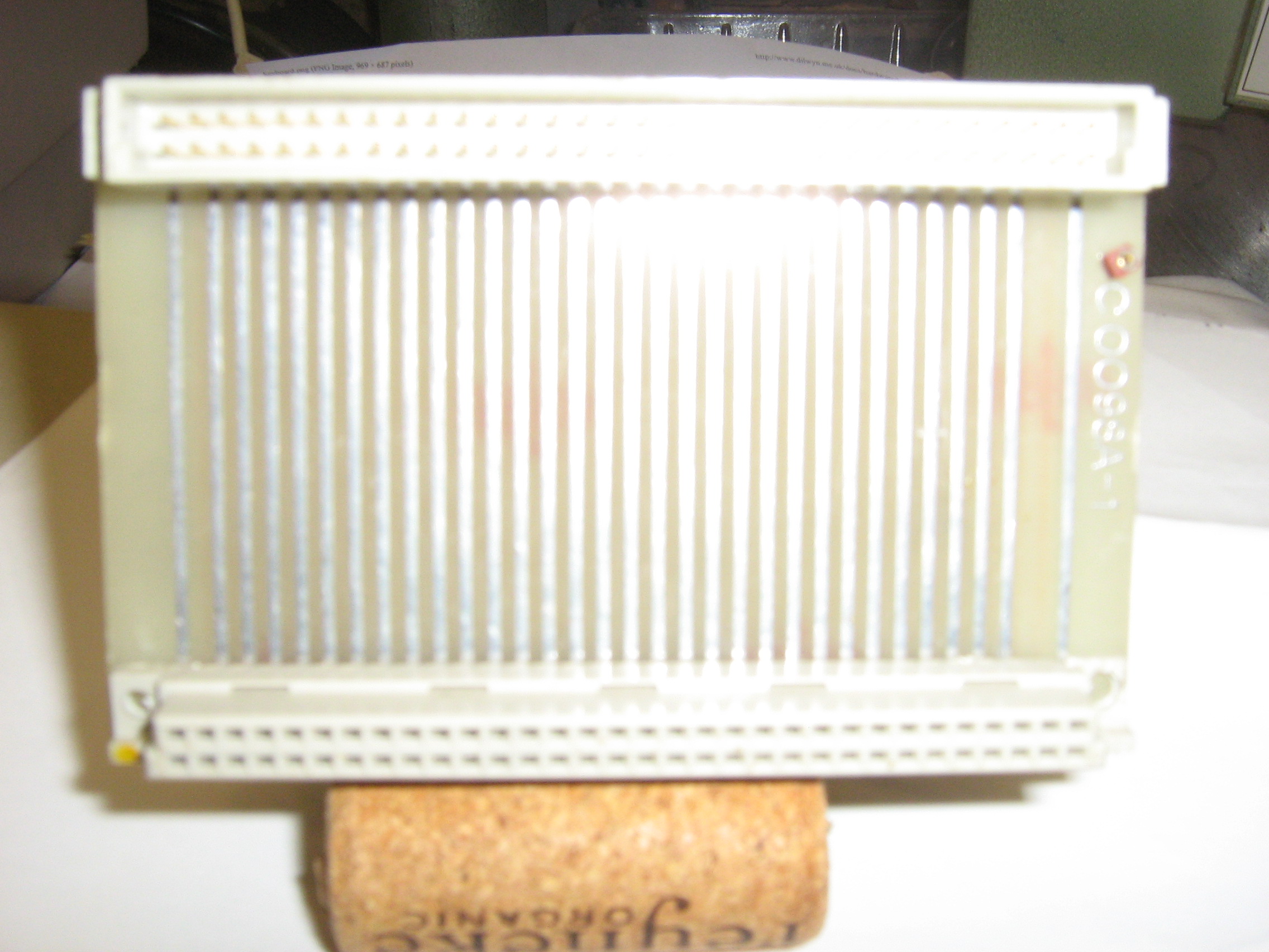

Is there anything special about a backplane? Is it not just all the tracks diverted and duplicated to one or more extra connectors?
I would strip the backplane down but there are nearly 200 solder joints so I'm a touch reluctant.
The backplane works without a card in it so I don't think anything is 'shorting out' Might be wrong.
As usual any help much appreciated
Dave[img]
[/img]

Ha!
Further investigation shows that the track to ASL has definitely deliberately been cut. So there was some connection from the ASL to the 7805 in order to get the Medic card to work. No solder on the 7805 input so that leaves me with Ground or ( i guess ) 5v.

KINGCHEF wrote:Is there anything special about a backplane? Is it not just all the tracks diverted and duplicated to one or more extra connectors?
A back plane should pass all wires straight through effectively being inert to signal paths it is down to the attached boards to do the logic. I would make all wires go straight through to start with a good backplane then see what doesn't work when attached. The ASL is an address select output from the CPU isn't it? Connecting an output directly to a rail will blow it.

Short time after my post I gave it another try.
The track on the backplane connecting ASL on the expansion connector has been cut.
The, now isolated, pin in the socket for the peripheral board has been hard wired to the GND on the 78S05 voltage regulator.
The board works.
I do not remember doing this 20yrs ago, who told me to or why it is necessary.
The medic board works O.K. plugged directly into the expansion connector after removing the backplane.
! suppose that I could remake the track but as it is working I will not mess with it.
The only thing I can think of, and I don't necessarily know what I'm talking about, is that the backplane somehow weakens the ASL signal.
Does that sound at al likely?

KINGCHEF wrote:The track on the backplane connecting ASL on the expansion connector has been cut.
The board works.
So the peripheral board doesn't use the ASL but if other boards do they won't work in the backplane is what you are saying. Since it works for what you want your are a winner. The chopping of tracks should really be done on the peripheral board to keep the backplane standard and other boards would work on it if they use the ASL.

When checking the backplane, Are you you just checking the tracks, or are you checking from 'pin' to 'socket'.
I am wondering if you have a problem inside one of the connectors.
Another thing you might want to check out. Is the PSU OK. If the 9v has ripples on it, it might measure 9V on a meter, but cause the 5V regulator to drop out sometimes.
Especially with different expansion boards having different load on the supply rails.
