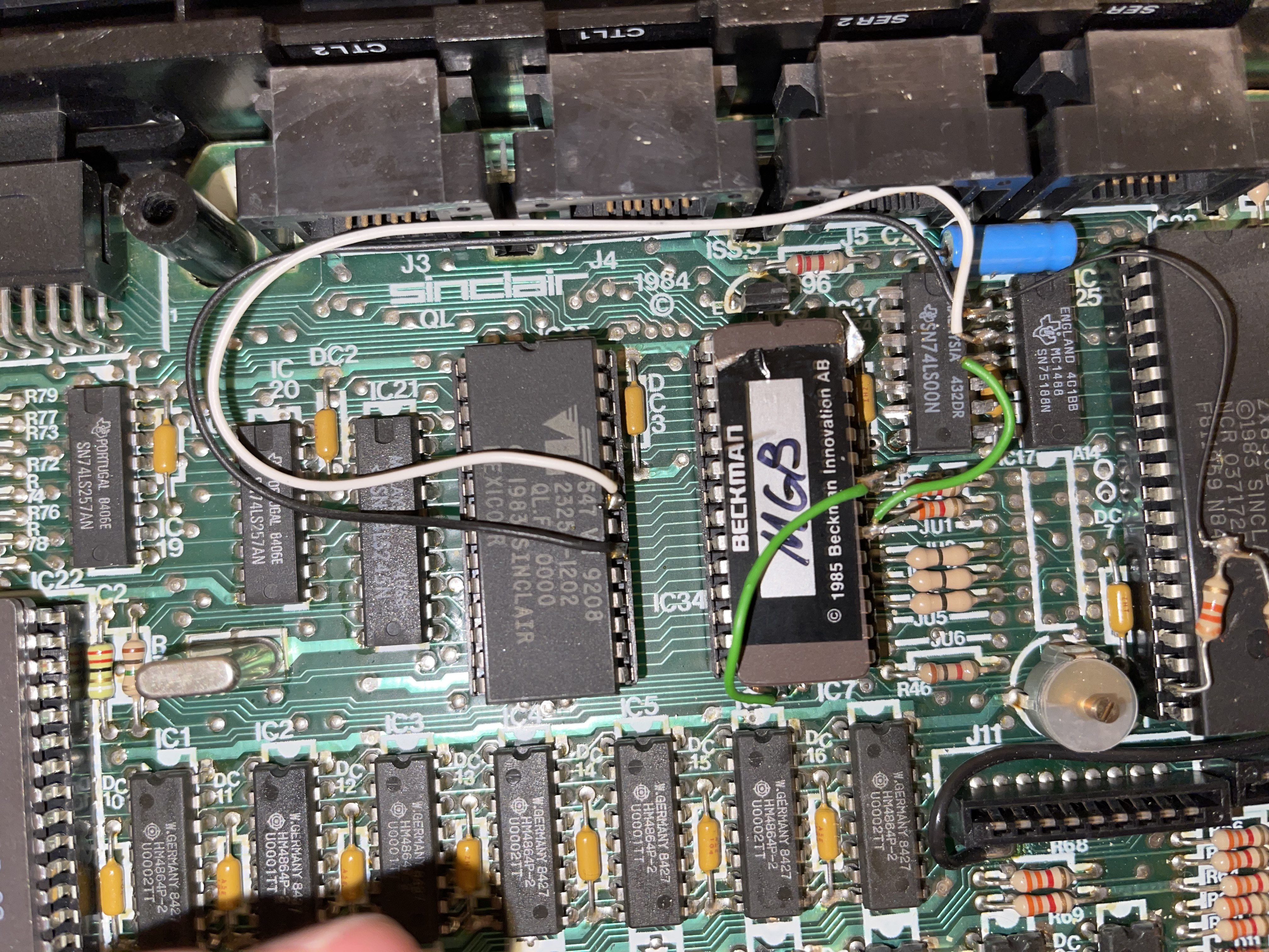

It is a Swedish Beckman version of the ROM. I have one myself. The keyboard of the QL has real printed keys for the Swedish keyboard.

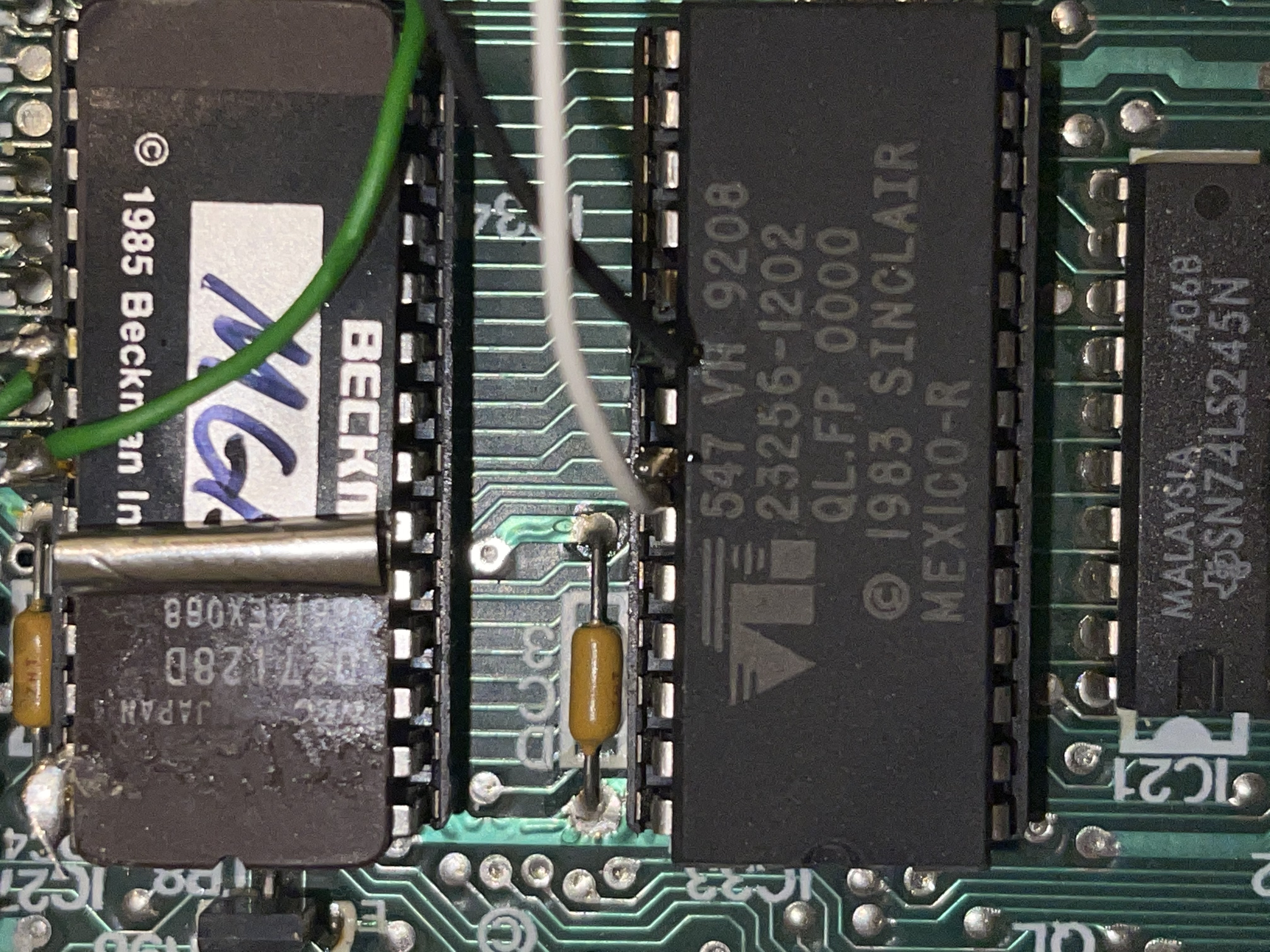

What's that official ROM on the left in your pic? It appears to start with an 'F' and the other part is hidden under the black wire.olpo01 wrote:It is a Swedish Beckman version of the ROM. I have one myself. The keyboard of the QL has real printed keys for the Swedish keyboard.
For MGx QLs that I've seen they all normally have an 'MG' on the left and then the language specific right hand one from $8000. eg MGG/MGF etc. I've never seen anything other than MG on the left.
