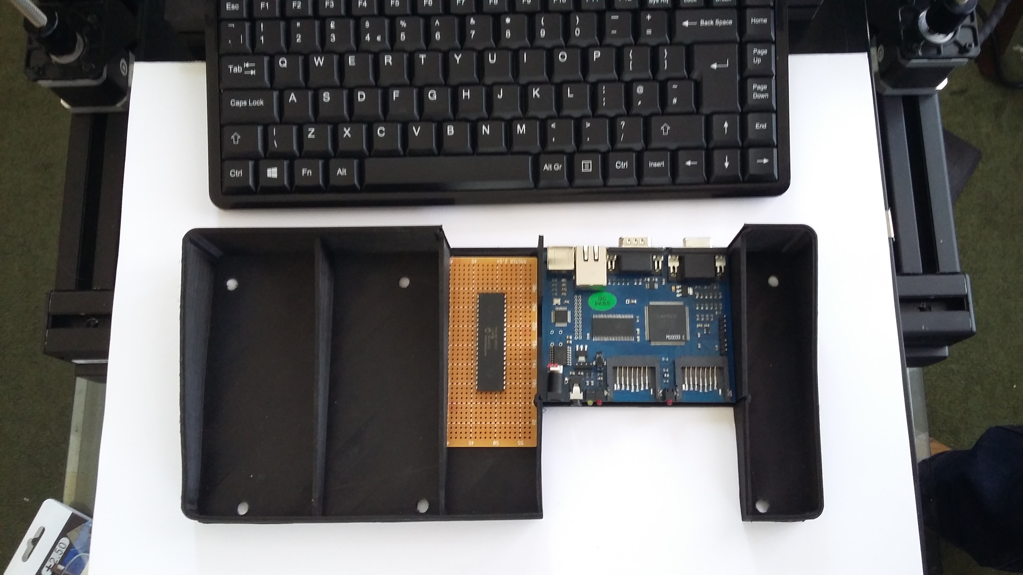

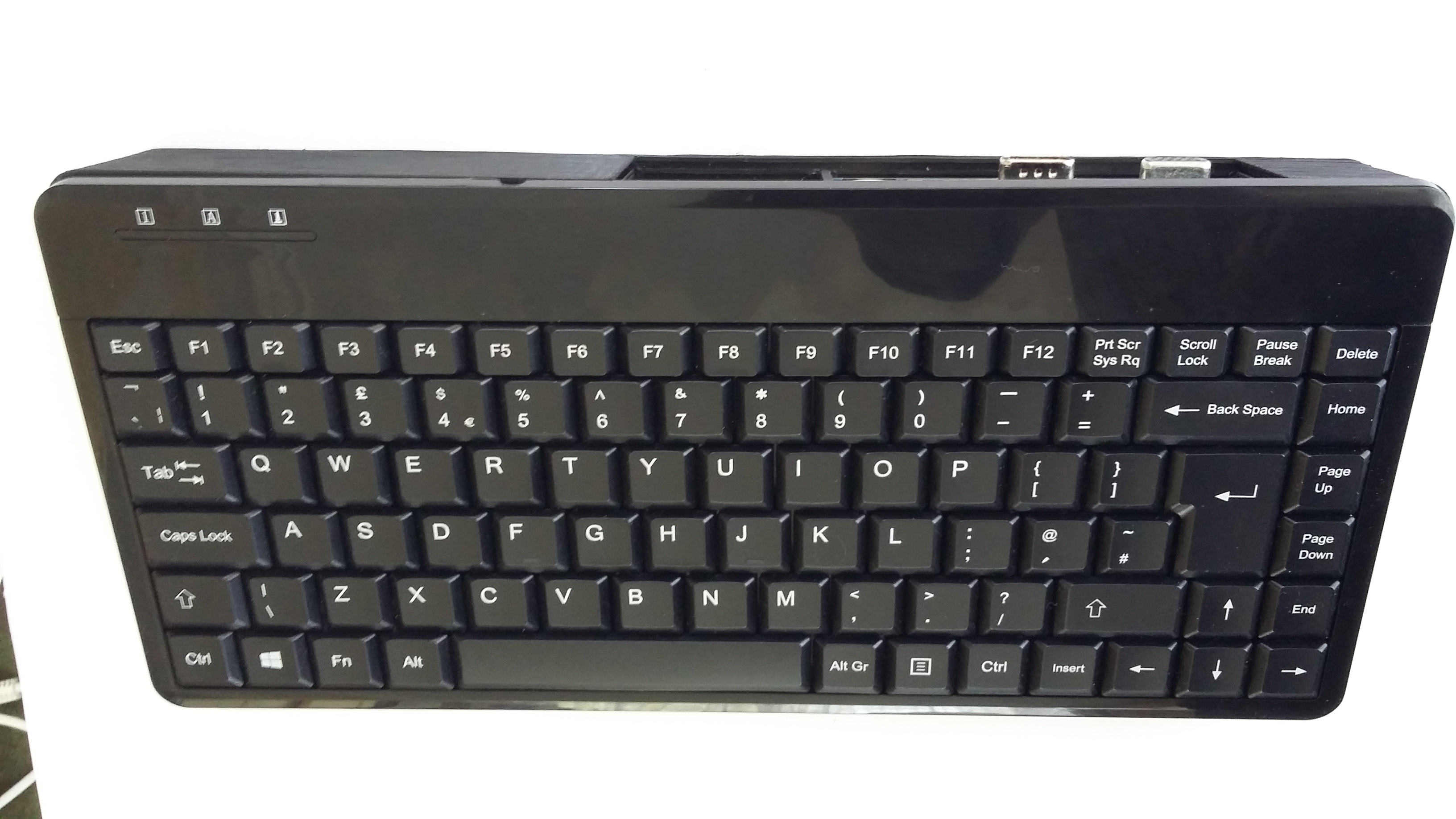

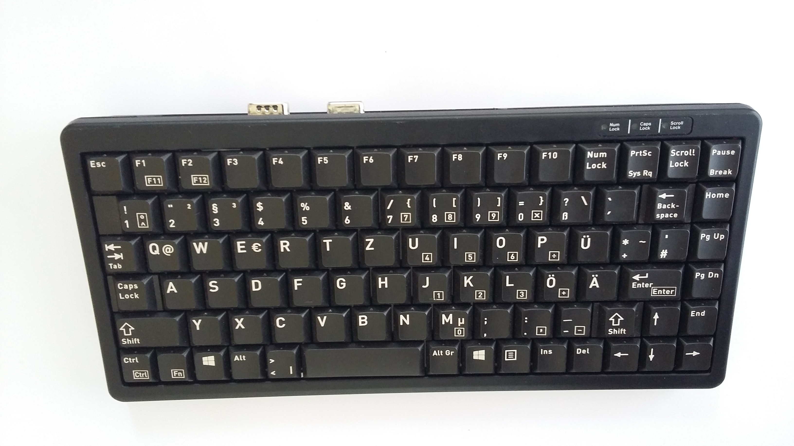

I already see the Q68 as a tinkerer's board and have made two keyboard cases to house the Q68
and a PICAXE micro-controller to assist with tinkering.(see photos below). There are no implementations
of SMSQE that are suitable for everyday desktop activities. Even the Raspberry pi400, with the unknown
millions spent on its development, cannot really replace the PC.

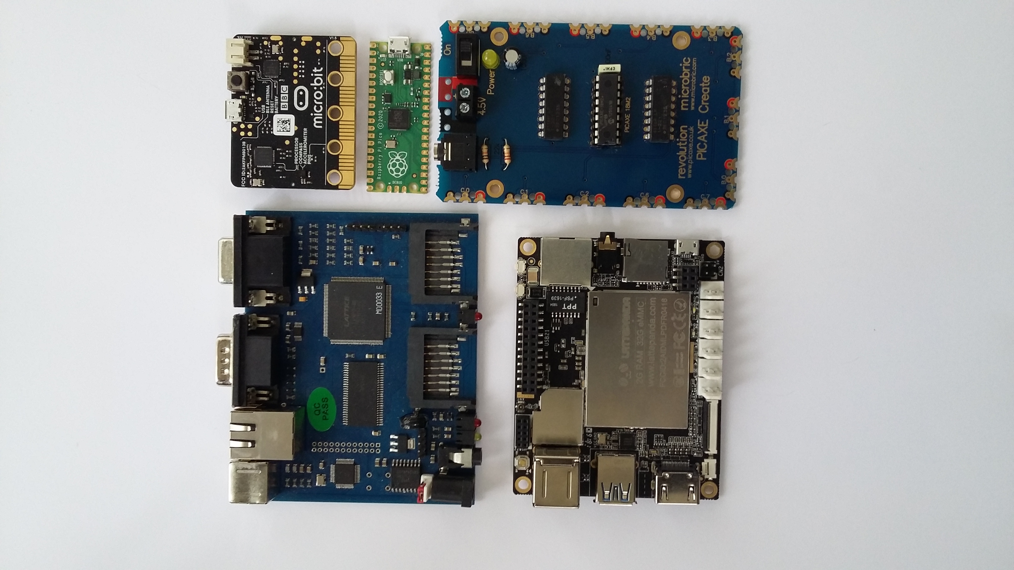

I would compare the Q68 and the Qzero (as shown in photo below) with any number of much more
popular experimenter's boards but with one major advantage. That advantage being the vastly superior SMSQE
operating system and the SMS2 programming environment it can support.
