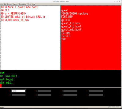

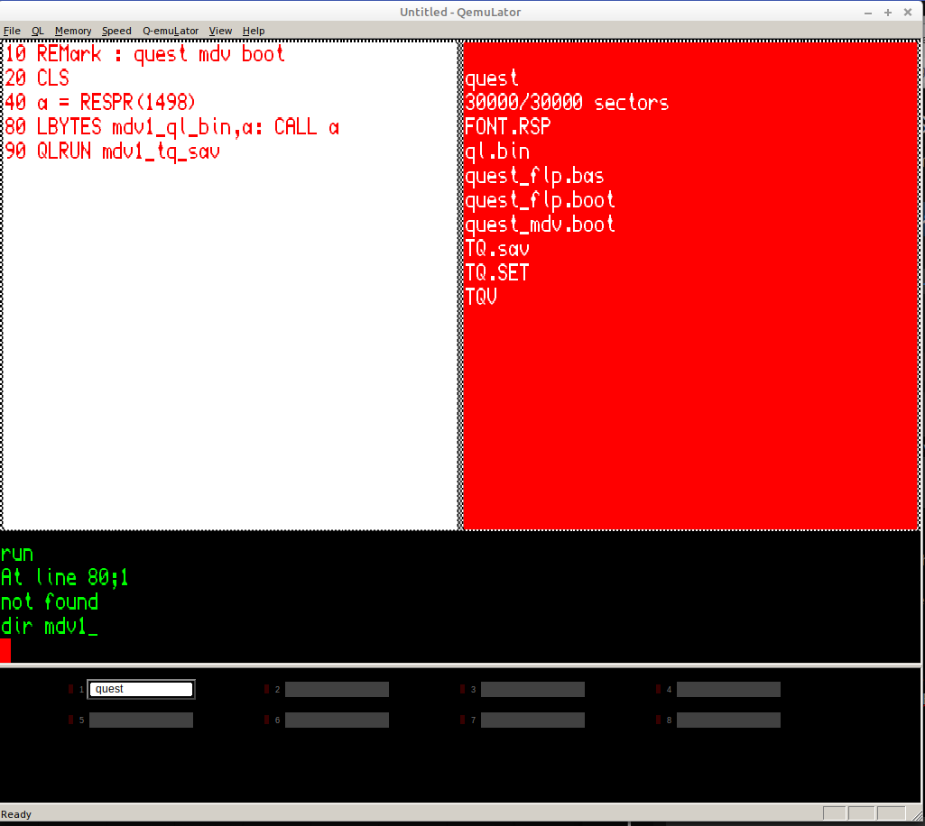

I had a quick look your problem with the quest.zip programme.
The quest.zip file when extracted gives: It seems extracting the zip archive file: quest.zip in Windows, or in my case Linux, extracts the files with dot extensions, the QL uses the underscore.
The Superbasic file: quest_mdv.boot listed in the screen dump wants to load: mdv1_ql_bin
But the extracted file as dislayed in the screen dump is: ql.bin
So clearly this is not going to work.

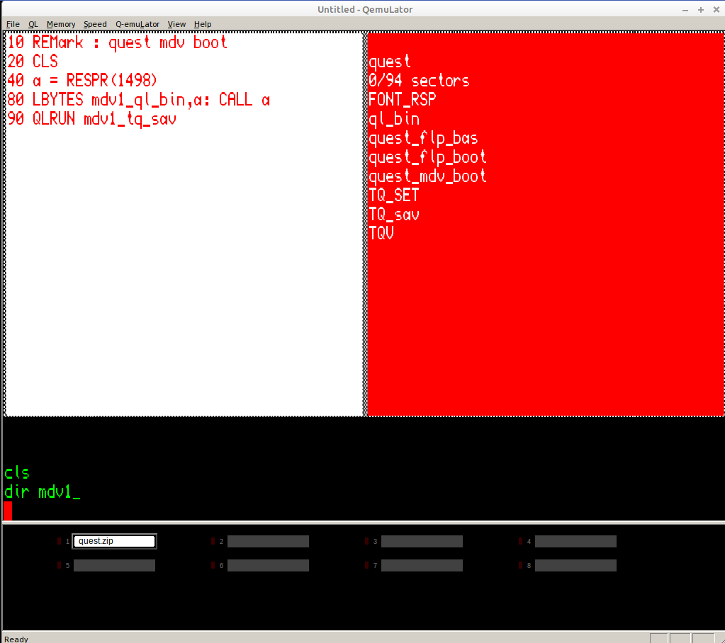

If the ZIP archive had been attached to the Q-emulator drive, which needs registration, the file would be shown correctly and the game would run. See attached screen dump of Q-emulator attached ZIP file in MDV slot: If registration of Q-emulator is not an option, the archive file quest.zip must be extracted with a QL version of unzip, in a QL environment, or rename all the files in the quest.zip file to suit the superbasic startup files.
