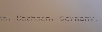

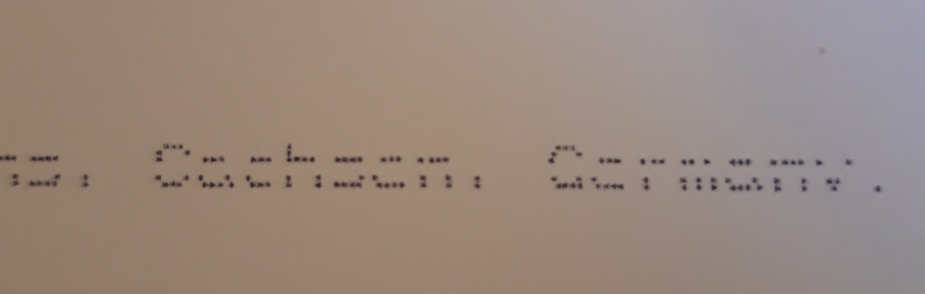

I have a similar problem with a QL printer. I only bought it because it had the box with it, but was obviously hoping it would work. It's nearly there, just missing one or 2 (or more) dots. Like this:
Edit: I actually believe the Sinclair QL printer to be a Seikosha SP800 and not an SP1000. The SP1000 looks quite different, with it's switches on the front, whereas the SP800 has the switches on the top left, just like the QL printer. Also, the PCB in my QL printer states 'Seikosha SP-800QL'.

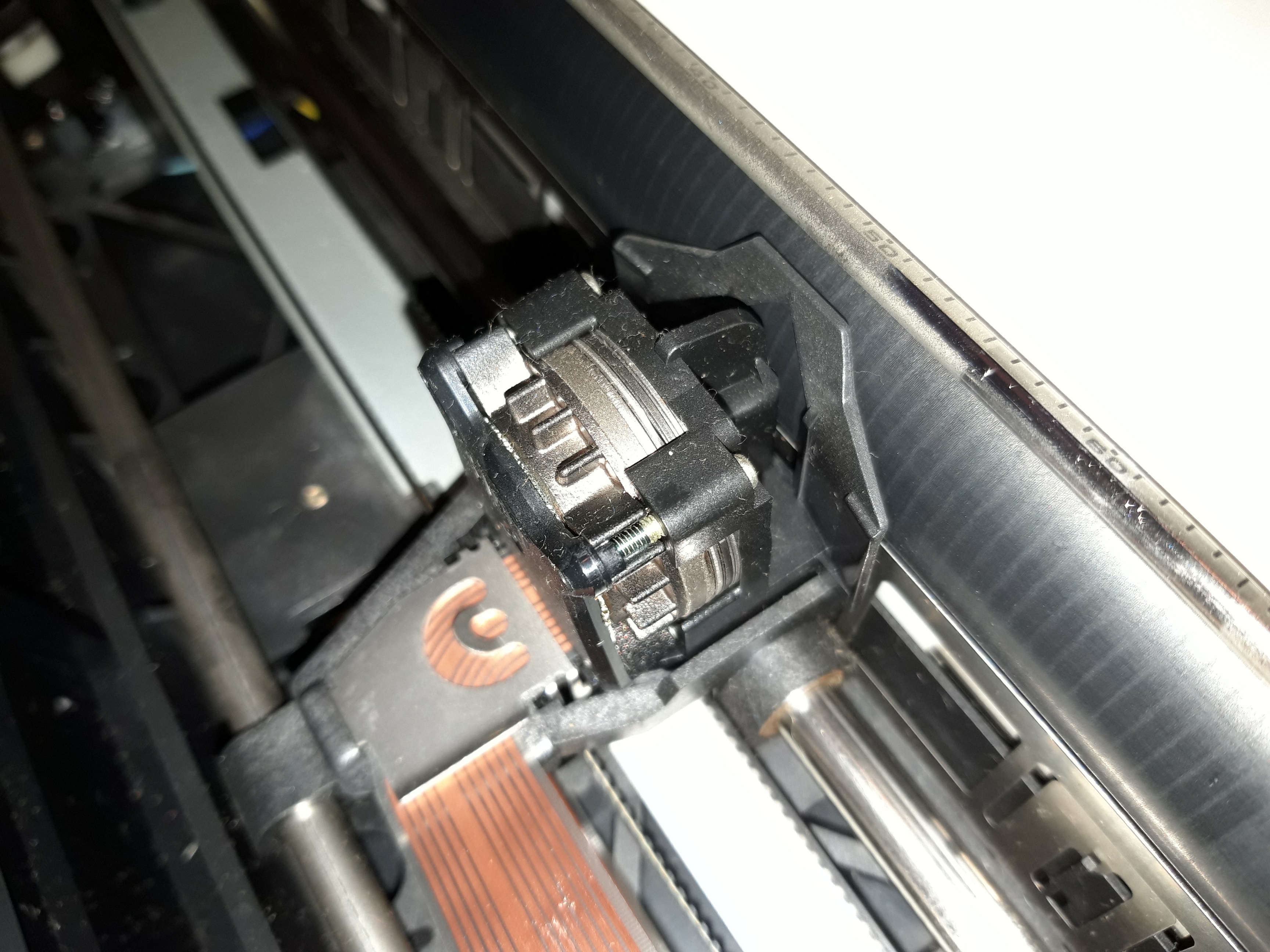

I've read above that the pins could just be blocked with gunk. But how do you remove the head of a Sinclair QL/Seikosha SP1000 printer? There are no obvious screws on the top. It looks like this:
And did anyone ever find compatible replacements? Any tips greatly appreciated. If I can get it to work it will be for sale.Edit: I actually believe the Sinclair QL printer to be a Seikosha SP800 and not an SP1000. The SP1000 looks quite different, with it's switches on the front, whereas the SP800 has the switches on the top left, just like the QL printer. Also, the PCB in my QL printer states 'Seikosha SP-800QL'.
- Posts: 1400
Re: ql printer repair woes
Aha, I did it! As usual, I should have played around longer before bothering you all!
You pop off the metal clip on top of the copper-stripy ribbon cable, then simply pull the head back. It does look really gunky around those pins, but they all look ok.
