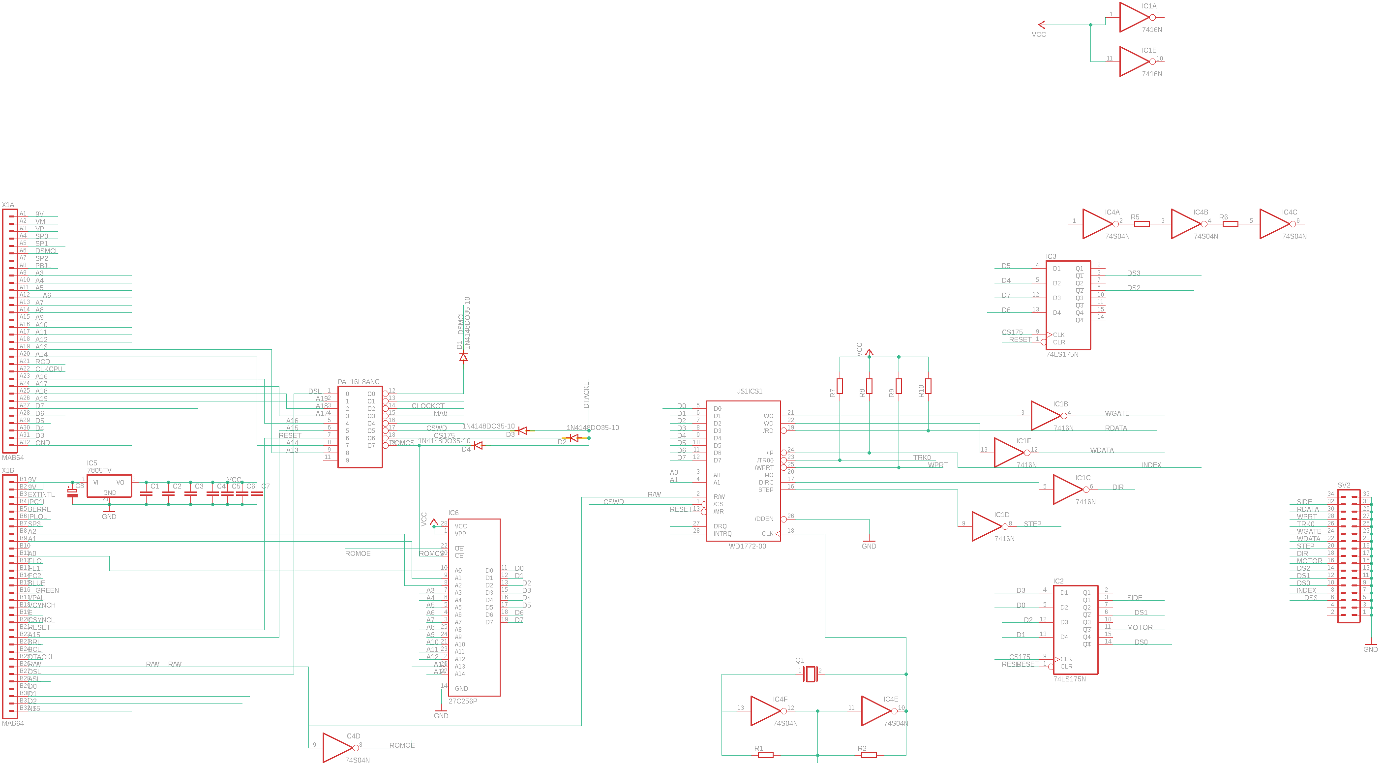

nikosdoykas
Posts: 134
Re: trumpcard 768 questions
Post by nikosdoykas »
shematics are from tetroid
trumpcard_2_orig.pdf
(111.41 KiB) Downloaded 142 times
for 2 version
pal 1 & 2 JEDEKS i dont remember...
TC1-PAL.zip
(944 Bytes) Downloaded 139 times
tetroid has meke a clone with extras
trumpcard_2.pdf
(114.75 KiB) Downloaded 141 times
all off this is in the forum...
this is the logic for memmory
and this the logic for dickdrive....(is the only think i designed) :lol: :lol: :lol: :lol: :lol:
Post by techy »
Thanks for all info !!
very helpfull to get this old material working again.
@Derek_Stewart ,
both cards are version one , can you share the pal's please

Posts: 134
i believe pal jedek is from version 1 i post (any one to confirm here....) the version 2 has only les chips on memory
