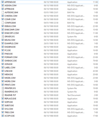

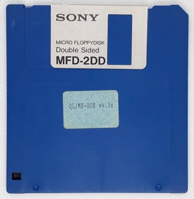

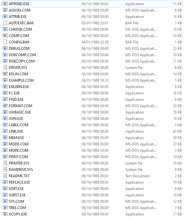

Anyone know what this is?
It's a 720k Disk labelled - with what appears to be an mdv label - "QL/MS-DOS v4.0x". It's content is in MS-DOS format and it contains these files:
The readme.txt file it contains contains the following, but doesn't reveal much:

Looks like all normal MS-DOS files to me. I can see no QL connection (apart from the label which looks Digital Precision in style) or am I missing something?

Here is a guess: -
If the label is DP - then could it be the version of MSDOS distributed with PC Conqueror/Solution PC emulator from DP

I did see that and wonder. So there was a trimmed down version of MS-DOS for the QL to use with the 'Solution' emulator? I do also have a similar Solution Disk, which also has an mdv sticker.

I used to have this years and years ago. It is indeed the DOS disc for Conqueror. You loaded up the QL disc first, then swapped this one in. After that, you typed DOS commands and got results. Eventually!
It was dire! Most commands had to load from flp1_, so you waited for that, then the execution, then got results. On a Trump Carded QL, it took ages.
Fitting an X86 emulator into a QL, with enough RAM to load and run DOS was great, don't get me wrong, but it was pretty much unusable. Sadly.

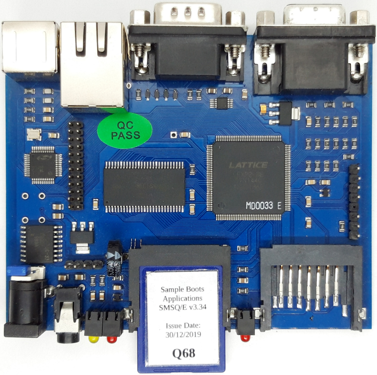

Like the new Q68 avatar. Looks a lot like the pic I did for the wiki. In fact, it is the same pic isn't it, but with the green QL sticker removed and the label on the SD covered? ;)

The Q68 boards should identical, as they came from the same PCB manufacturer.
There is a QC label on all boards, sometimes on the underside. But the label does not really mean or guarantee anything.

Chr$ wrote:Like the new Q68 avatar. Looks a lot like the pic I did for the wiki. In fact, it is the same pic isn't it, but with the green QL sticker removed and the label on the SD covered? ;)
Yes it is and many thanks for your wonderful pics!
