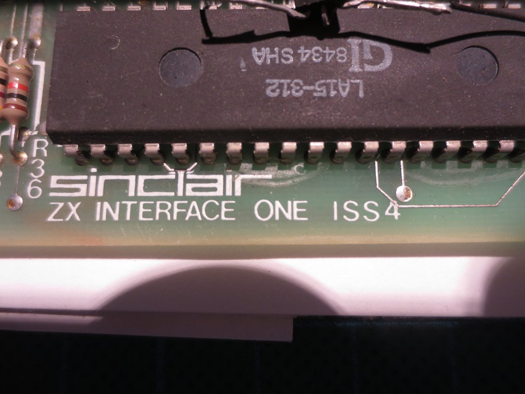

As i am struggeling to get my if1 going ( looks like a dead doornail to me now ) , i need to verify the functionality of the zx microdrive .

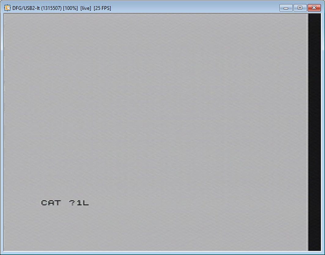

With regard to the IF1, the thing that is most likely to fail is the ULA chip as they get quite hot. When that is plugged into the Spectrum even without the mdv attached you should be able to tell if it's at least being 'seen' by entering e.g. CAT 1. If it isn't present at all it'll report a bad command or something like that because the CAT command is I believe (someone will correct me if wrong) within the IF1 IF1 ROM. You could also try PRINT PEEK 23729 which should either return 0 for the v1 IF1 ROM or 80 for the v2. Let me just check what that returns of there is no IF1 attached at all....

Just tried it... if you try to enter CAT 1 on a spectrum that has no IF1, it doesn't accept the line and flashes a '?' before the '1'. Similar thing happens if you try FORMAT "m";1;"name". If those commands are accepted even if the mdv does nothing then you know the IF1 ROM is at least 'present' and connected.
The PRINT PEEK also returns a 0 if there is no IF1 present.

re if1 , i tried all possibilities of cat and the peek but no response at all ,
altough i found out that the cat command resides in the spectrum rom with or without if1 connected
will there be some points to test there ??

When IF1 is connected to a Spectrum, entering an invalid command caused a paging in of the IF1 ROM, which rechecked the validity of the command. CAT is in the Spectrum ROM but without the mdv parameters, hence it would fail and then work when IF1 kicked in.
Commands had to be present in the Spectrum ROM which is why the IF1 commands just added "invalid" parameters.
Looks like yours isn't kicking in.

And as Norman says, the CAT command is present but the with the '1' (or 1 up to 8) after it a Spectrum with no IF1 connected won't know what to do with it and it will show the syntax as wrong. Are you sure your Spectrum expansion port connections are clean... a basic thing that you've probably checked but it can be important.

Regarding the IF-1, as well as a defective ULA, it is also quite possible that the Spectrum's z80 CPU is (slightly) defective.
The IF-1, along with certain other Spectrum peripherals rely on a working 'M1' (Machine-cycle-1) signal from the CPU, active during the instruction-fetch cycle.
An unexpanded Spectrum will work quite happily with a faulty M1 line, as will many interfaces (e.g. Kempston Joystick, etc), thus it may go unnoticed until you attach the IF-1.
Thus, it is possible that the IF-1 is working, but to operate correctly, the z80 would need replacing,
If you also have, say, a Multiface-1 or similar, this too requires a working M1 line, and would not work on the Spectrum either and thus would validate whether or not you have a defective z80.

ula hasn't burnt out case is without heat damage .
so here also up to next step ............if you can help me
