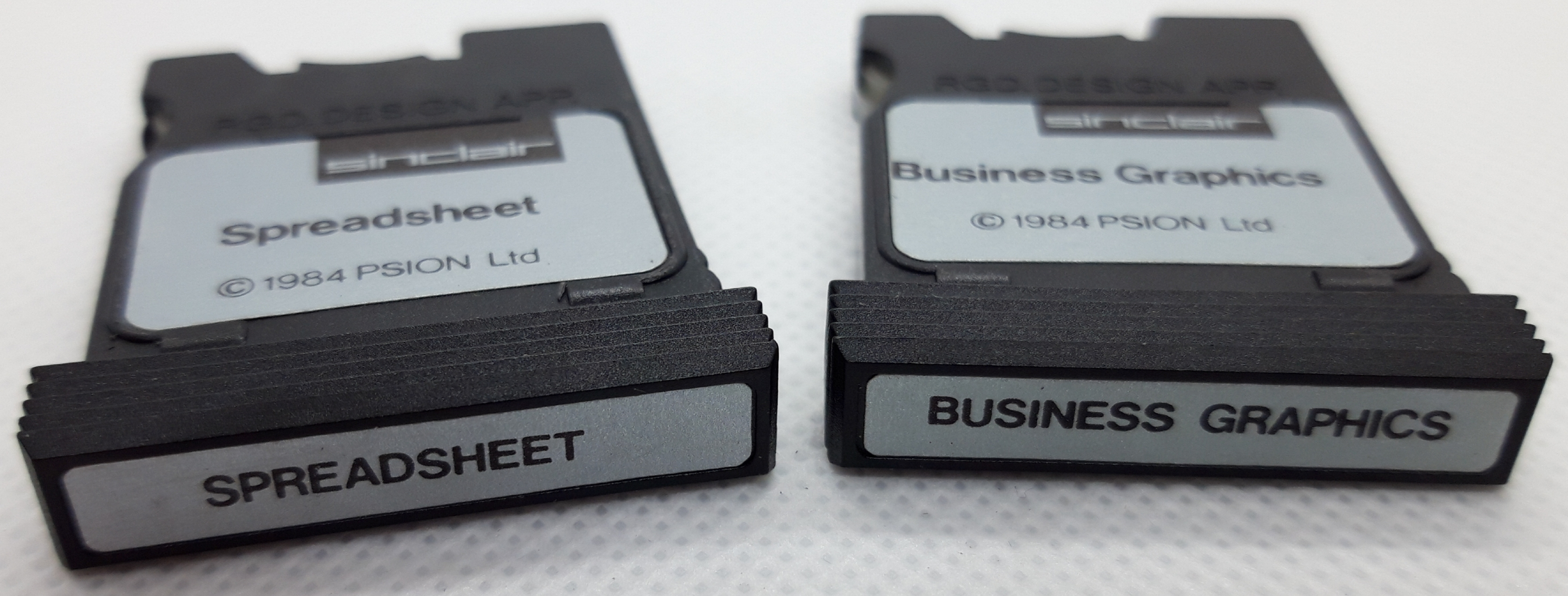

I was surprised to find these two gems in a lot of mostly Spectrum related stuff that I received today. I get a little bit excited by QL related original stuff, for which google holds no images (how sad is that)! I know that the actual US software is available on Dilwyn's site, but here are pics of the original USA QL's 'Spreadsheet' and 'Business Graphics' hardware. They are in very nice condition but they do have their original foam pads, so I won't be trying them out.
I'm also in 2 minds about putting new felt on them. Do I re-felt and see if they are version 2.1 as expected, or leave well alone and just dl the publicly available version if I really need to?!
Just 'Database' (Archive) and 'Word Processor' (Quill) to find now.

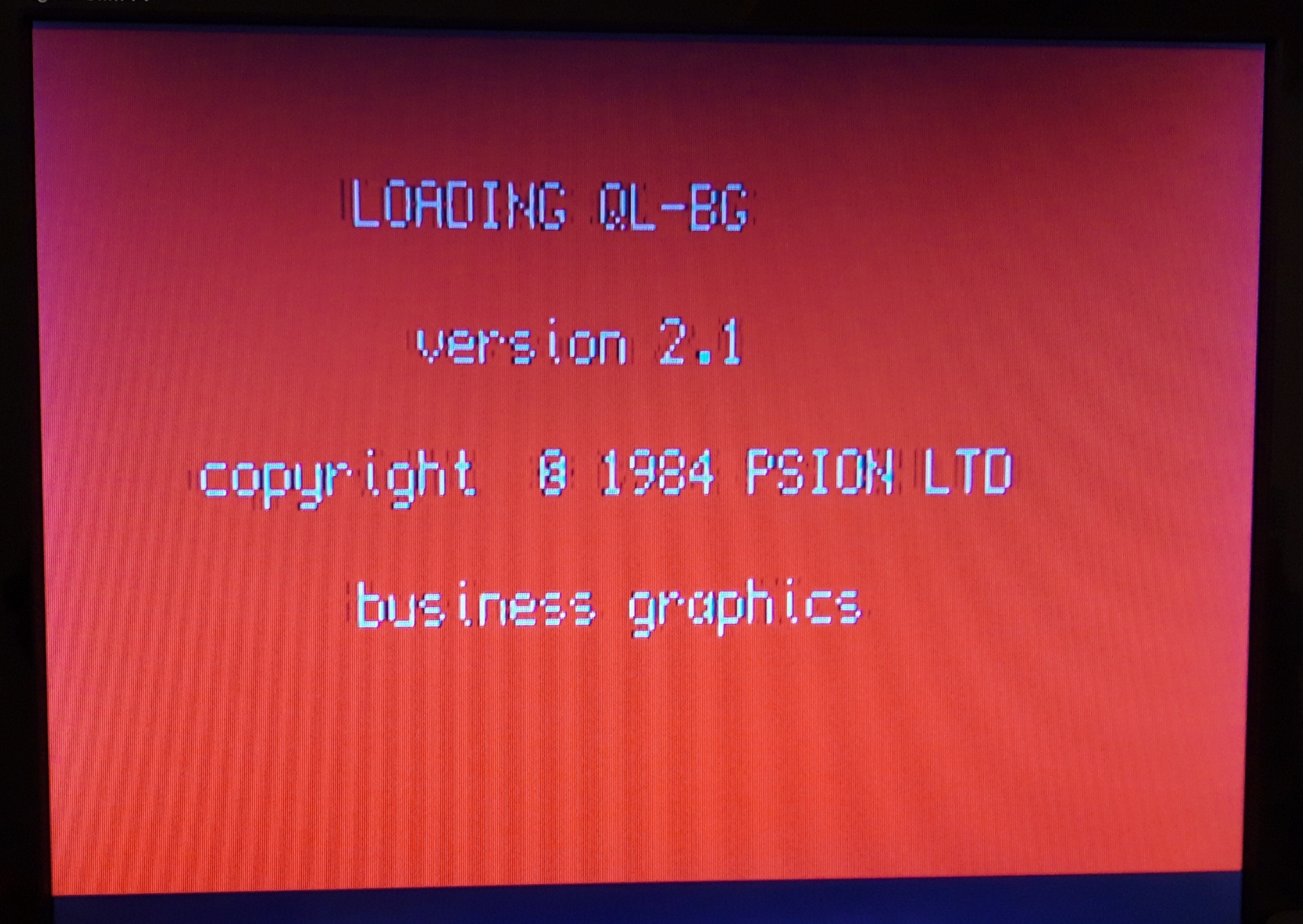

I'm going to re-felt them and then see how healthy they are, what I can get to run etc. Be interesting to see if there are references to the UK names, what the red start screen looks like etc.

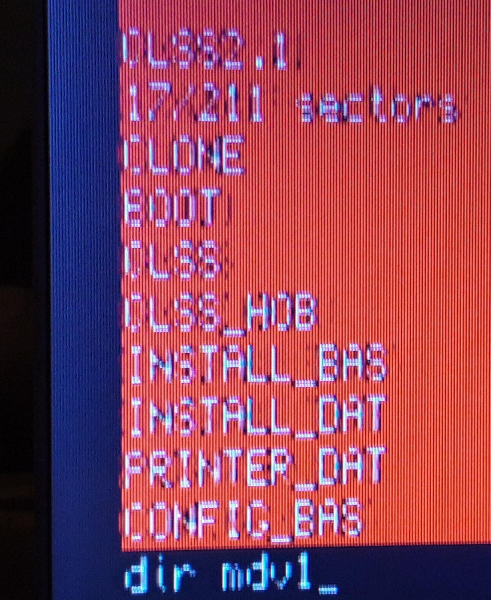

Ok, well the re-felting went fine and I was able to dir both of them. v2.1, same as provided on Dilwyn's site.
They don't run though and on attempting to copy the contents to win1_ both failed at the main 'exe' files, which are called QLSS and QLBG.
I suppose I could format them 6+ times to stretch and identify bad sectors, then copy the original files back over (in the correct order) and they'd be good as new (as good as mdv cartridges can be).
