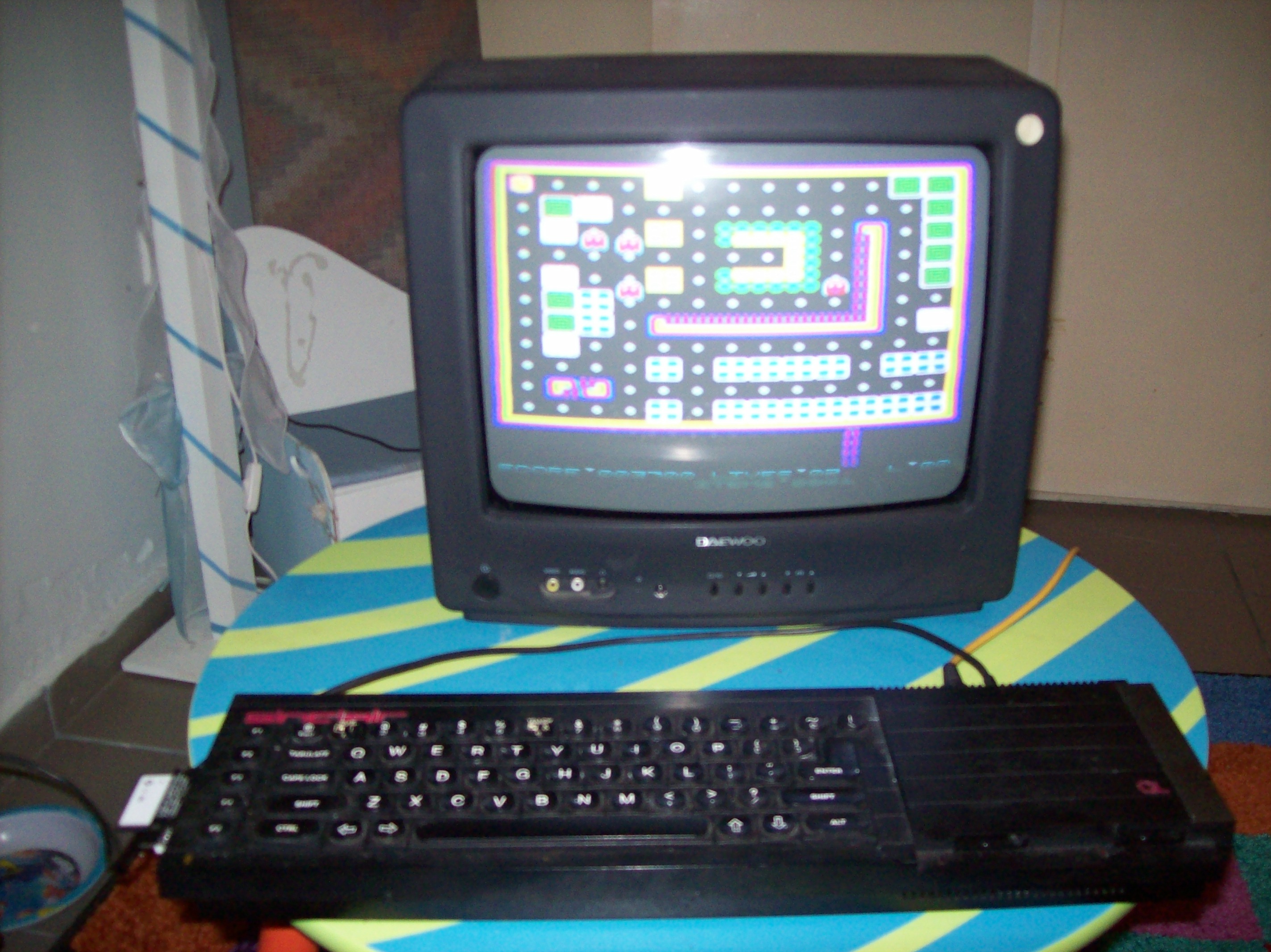

hello has enybody the superbomber from talent ......on real ql
also i got the packman(mcrunce) but it freeze (space bar not respond)on real ql
many thanks

i try it on jm and minerva 1.98 an yes is from dilwyn page

hello i got a qubata(qubide) so.......... i can unzip on a real ql and the both files so i can try the comparization to areal ql? and the medic? so i see that the medic has 4 files........ i presume that can be run from win1_medic xmm ... i will mece the unzip to a real ql and i will feed back for ALL

crunch working cosmic working metropolis working treasure working
inside folder on win1_
paint dont work inside folder works partialy on standalono on win1_(i believe has a code loader on the files so work like flp(win_use flp but partialy)
