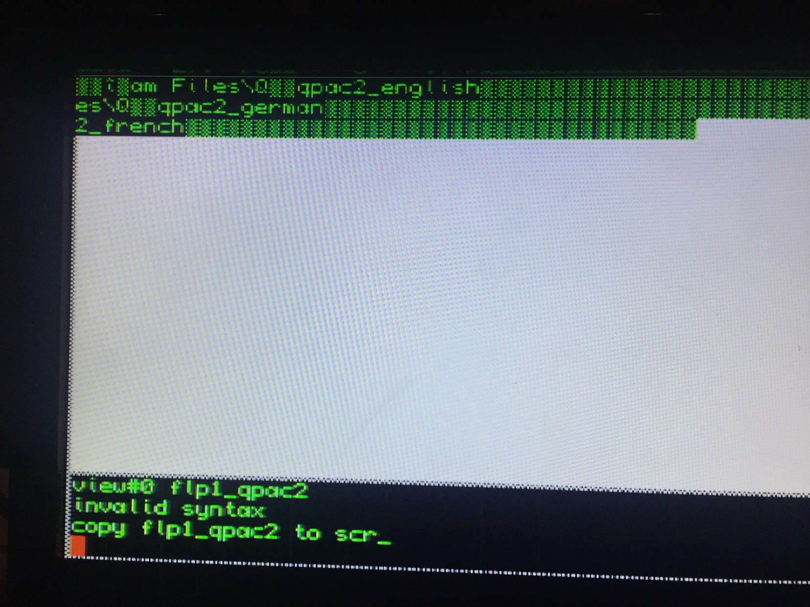

Just a thought. Are you trying to use the same copy of QPAC2 that you are using with Qemulator?jivrt wrote:You are right I’m very uninitiated. Of course there is this cold boot with stripes on the screen then a monitor window with stippled borders. So far so good, QL is responsive and working. I cant tell if I’m in smsq/e but I assume so. But when I lrespr qpac2 the QL Freezes and becomes unresponsive. When I do the same on qemulator I can use pointer enviroment and can call some windows,
Depending on where the Qemulator copy of QPAC2 is stored, and how you are copying it. It may have a Qemulator header added to it, which would almost certainly crash SMSQ/E when you try to LRESPR it.
Before you try to LRESPR QPAC2, Use VIEW the qpac2 file and look to see if at the start of the files it says "]!QDOS File Header"

Well then the qpac2 file if copied to scr shows There is an english, french and german file. But if I dir flp1 there is no subdirectory, only qpac2.
