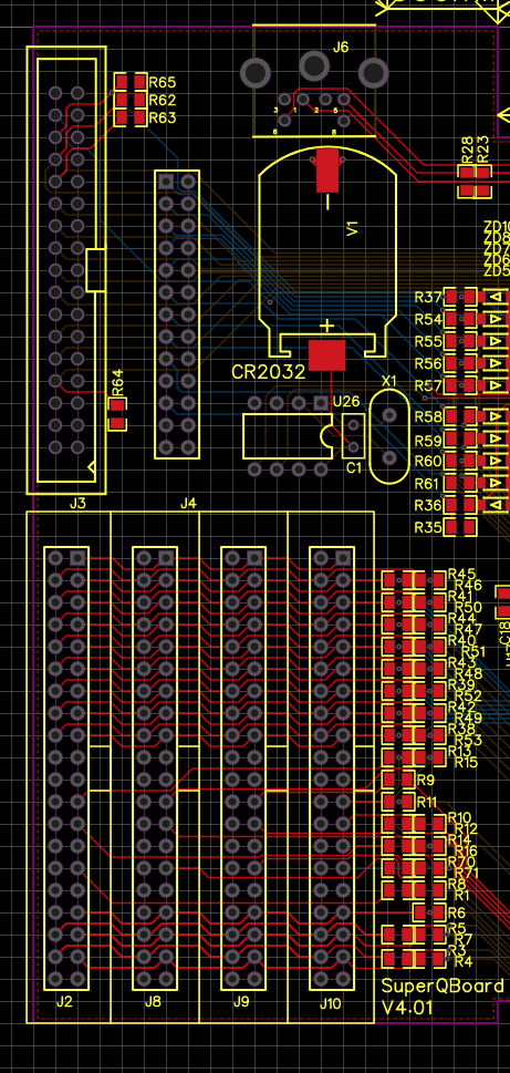

Nasta's expander has existed and several were sold.
Nasta redesigned the QubIDE a few years ago to offer some extended features. I incorporated it into the nextgen SQB but unfortunately never completed the project. This was in part due to it using a large number of GALs, but also due to my own lack of skills. Those have come along since then and I have been revising the design - replacing all the GALS with a single ATF1508.
Here's a notion of what's possible:
SQB v4 IO area
